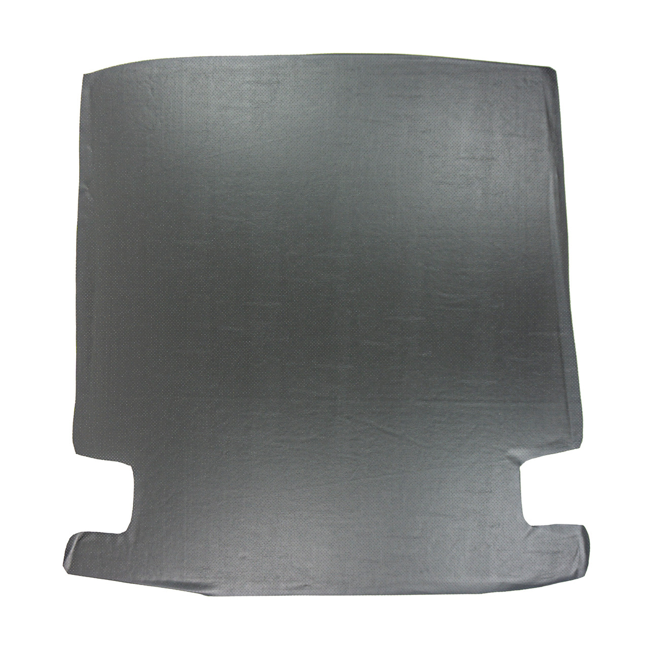

How do you decifer what the original headliner was like?
Would it be the standard black perforated for mine and would the cowl tag say or the full PHS?
Also, do you like this one?
https://www.classicindustries.com/product/hlb01.html
A 74 firebird would have the perforated vinyl, pre 73 used the bow type headliner, at least for 2nd gen firebirds. Cowl tag wont show any details on the headliner & neither will PHS from what I recall seeing in my 3 PHS packets, unless headliner is related to standard or custom interiors.
Never seen the TMI headliner, er hairpiece, but that price seems rather high for a 1 piece with perforated vinyl, unless they redesigned the ABS backer theres really no difference in the foam backed vinyl material to justify that price IMO.
Based on your initial post saying the headliner looks new to you buty sagging a little, I would just try some 3M adhesive to reattach it, or if the backer is good, save a bunch of $$ and just buy the foam backed vinyl and glue it on yourself.
Old 03-11-2024, 02:09 PM
Thanks 78w72
So in my case if the interior is all black she probably had the black perforated?
How do you like that classic industries unit?
Yes, I may just end up glueing this one for now as all the front end pieces I need is going to blow my budget anyways.
Old 03-11-2024, 05:35 PM
78w72 78w72 is offline
Location: iowa
Posts: 5,598
Im pretty sure it should have been the perforated vinyl originally, there may have been a cloth material too since I have seen quite a few firebirds & camaros with that but not sure if its was original.
The CI unit looks like just the standard PUI headliner you can buy anywhere, probably cheaper at summit. I bought the PUI 1 piece perf vinyl from summit a few years ago for my 72 firebird and they had the best price, i ordered it without the seat belt cutouts though since 70-72 didnt have the belts mounted there.
If yours is in decent shape I would re glue it or replace just the vinyl if/when needed. I did that on a T-top 81 using the original cardboard backer.
