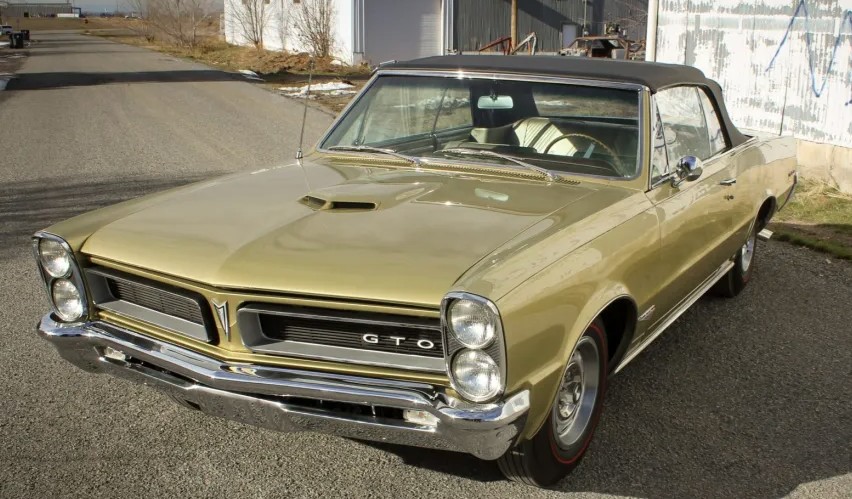

Please give me your feedback on this 65 GYO for sale. I'm considering it for purchase:
https://bringatrailer.com/listing/1965-pontiac-gto-93/

Well, it's a Jim Mott restoration. The car will be a perfect, top shelf restoration. The only decisions here are is it what YOU want, and how much are you willing to pay. Not my favorite colors, but I am in the minority. That combo seems to be very popular within the hobby.

Agree with the above. Have known Jim Mott for years and his restos are top notch. Has a good parts supplier also, ME.

The only nit I can pick is the splitter location does not look right to me.
They look like they are angled down a bit much.

1) The Dual Exhaust Splitters were added, as they are not on the PHS and installation is off, not like factory.
Several other options were added that are not on the PHS.
2) Car was originally built with Standard hub caps (dog dish), not Rally Wheels.
3) Also this car came with white wall tires, not Red line tires.
4) Instrument panel pad.
5) Mirror, outside LH.
Extremely nice restoration, but if this car were judged at MCACN it would lose lots of points from all the added options.

60sstuff Have you ever had a car invited to MCACN? I have had my cars judged at MCACN. My Black and white 65 scored 991 out of 1000. I can tell you from first hand experience this car would score amazingly. MCACN judging is no where as hard as GTOAA and this car has already been shown there. Did you know 62BV (RIP) won best Pontiac at MCACN, there was not one thing on his car that was same as the PHS. BTW, when the person that restored this car goes to MCACN he is usually asked to be one of the judges for Pontiac cars.

Below is comment from Jim Mott regarding MCACN and GTOAA judging standards and also splitter location. One other thing I do have Hurst wheels for the car but we did not show it at GTOAA with hurst wheels, because they will deduct points for Hurst wheels. MCACN will not.
I am a judge for MCACN and GTOAA. Both MCACN and GTOAA accept options that are added to a restored GTO as long as they are correct for the year and installed correctly.
As to splitter length-the location is not adjustable. The splitter bracket determines the location. Only one reference was ever supplied by Pontiac for splitters. I have provided a photo of it. NO dimension for the extended length is provided. The stainless sections are not acknowledged in the factory drawing. Current reproduction splitters are 1 inch longer than originals.
Attached is reference and also picture of a factory original splitter car. I do believe its the angle of the pictures that is throwing people off.

If I were looking to buy, I would bid to 80K and hope to get it

At 90G with 18 hours to go.

Day 1: Remove RH wiper arm and reinstall. Probably
won't see rain, but once you see it you can't unsee it
being parked against the trim.
Day 2: Q-tips, lacquer thinner, and lots of elbow grease.
Not exactly a deal-breaker, but at $100K? Kinda sloppy.
Day 3: Oversized mudflaps to hide the exhaust splitters.

Not even close. The action is now over and bidding reached $126k and the reserve was not met.
