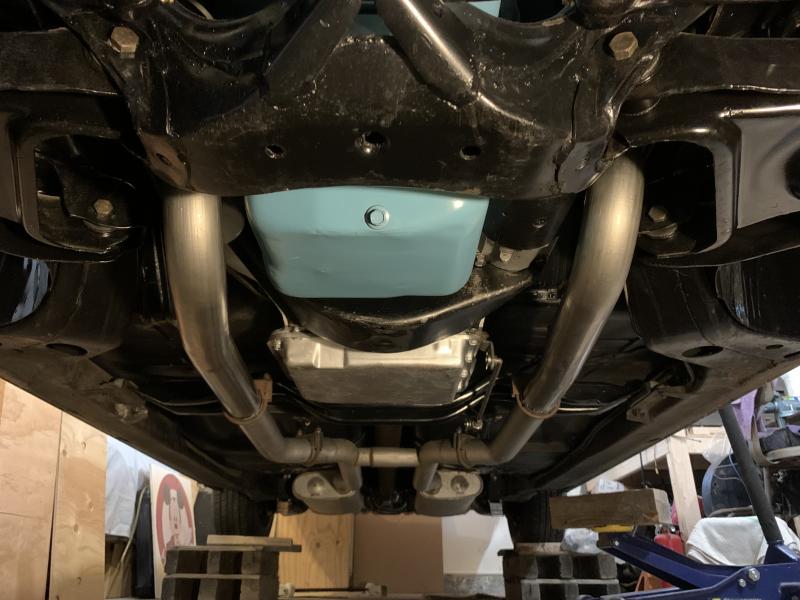

I run them with a Flowmaster mandrel bent aluminized 2-1/2” system with H-pipe on both of my 1964 A-body Pontiacs.
Not all turbo mufflers are created equal, the cheaper/generic ones can be too loud and annoying.
ID:	633074   Click image for larger version

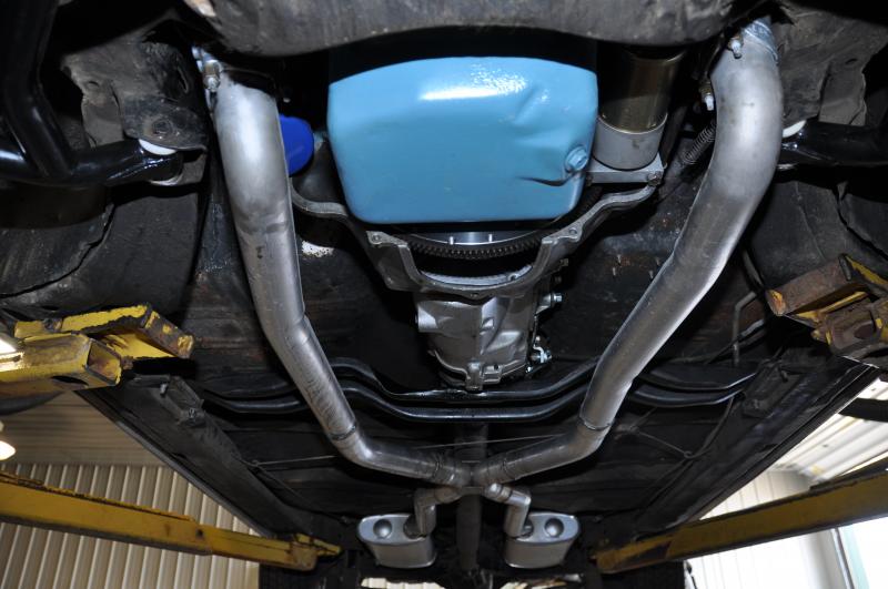

I've been running a 2.5" exhaust with X pipe with the DynoMax 17749's in my '64 GTO convertible for 10 years. I primarily drive with the top down and the exhaust is far from loud. I put these on after installing my 462 in 2013. This exhaust replaced the 2.25" exhaust system that I had put on in 1994 when I was running the stock 389. Figured bigger motor needed a bigger exhaust. I'm very happy with it.
ID:	633048   Click image for larger version

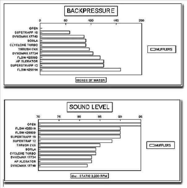

Here are some tables from Jim Hands Muffler Test:
Thank you for the data. I was hoping to find something like that.
