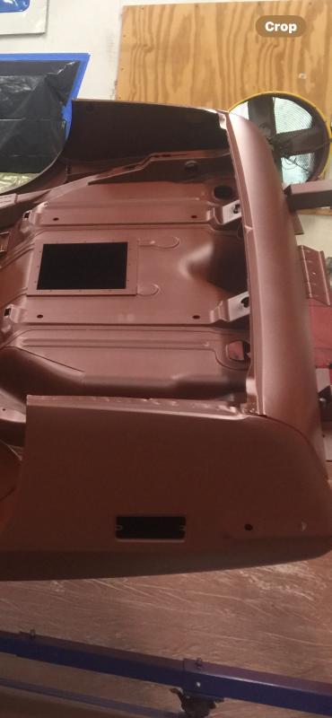

Hello all,
I know this is not the place for a wanted add, but it directly pertains to the 70-73’s and hopefully will help the hobby in the future.
I am looking for one or both trunk drop off to cross rail filler panels. I can mirror one if I can’t get both.
I hope to either reproduce these myself or have it done. (May have someone to help if I can’t pull it off)
The panel is located behind the lower red circled area in the first picture.
It’s the rusty parts in the second picture (stolen from the net). (The black are Camaro and are different)
Thanks,
Stuart “Stan” Landreth

Ok, here is some info, and pics.. this California car got hit in RR corner and below many decades ago.
The small panel in question you can see is tack welded, as original, to the inner rear panel. This panel is actually a " camaro " repop part sold for a firebird, because... " same same ya know" .. Obviously I had to beat it and reform it to make it right for a firebird. That said, ALL the repop Quarters, or patch panels ARE WAY wrong in this area.. The repops just come around the bend and go straight, vs a compound dynamic curve WITH a shelf in it to correctly FIT this panel, like original quarters have. Most body shops IGNORE all this and will even solid weld the outter tail panel to the quarter ( WRONG). IF you question the " seam" they get a grinder and make one... Wrong.. ..So I put a modified repair quarter which was ready to weld, up to the " inner tail panel extension " part way on the car so you all can see how it is Supposed to Lay in the extension panel ( part in question).
The Outter tail panel Is ONLY attached at the very bottom edge on the Inner tail panel. It comes with a rolled EDGE on the sides. On a FACTORY Sheet metal car there is an air gap, shown on another car with George Washington helping out. This is factory sheet metal. Take a good look, ask Questions.. LAST Pic is factory Untouched Driver side of same car. One my phone it's hard to get pics to load right side up, sorry PS Paint on inside is Dp74LF. with spot clear

When I built my 71, the quarters, trunk drop offs, cross rail, and tail panel were very accurate to the originals. I had one sourced original filler panels at the time and they fit excellent.
I attached a pic of my 71 with an original filler piece. Wish I would have made a 3D scan of it 10 years ago when I took this picture.
You can barely see it attaches to the rear cross rail and the trunk drop off.
The tail panel does not attach to the filler nor does the quarter. Kinda hard to explain.
When you put the quarter on it spot welds to the lower horizontal of the trunk drop off. The tail panel spot welds to the lower horizontal of the cross rail. There is one place that a couple spot welds go on the bottom corners attaching the lower most part of the quarters to the lower of the tail pan.
That being said, I hope someone has one I can use.
