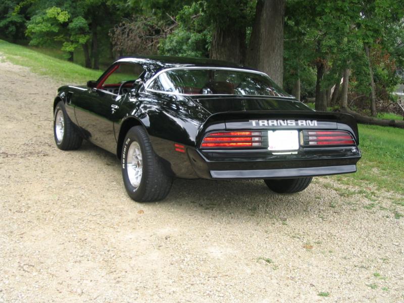

I ran 255/60R-15's without issue on my '71 Formula.
Dennis
