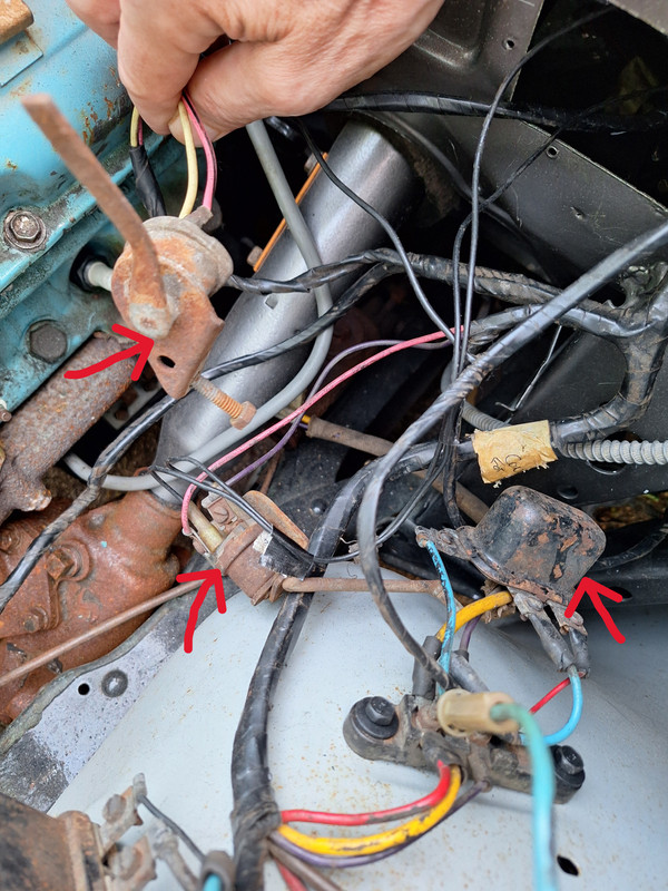

@peters23 I've taken a picture that shows three parts in my wiring harness. I have no idea what they are or where they should be mounted. Maybe you can help me out?

Lower right could be the horn relay, but colors don't match factory brown, red and black.
The lower left could be the neutral safety and backup light switch, but would need a bracket that I don't see to attach to the steering column. Wiring diagram shows black, red and brown wires, which does not match yours and shows a 4 terminal switch. I guess a manual transmission car could have a 3 wire switch.
The upper left switch is likely a brake light switch, but I can't find a drawing of it in the 1960 Master Parts Catalog. Wiring diagram for 57 Pontiac shows one side of the switch has a pink/black wire like your pictures shows. Diagram does not show wire color on the other terminal.

See below for a few more clues.
The switches with the linkages don't seem to match what I am seeing on my car, which has power brakes and automatic transmission.
If yours is manual transmission and/or manual brake it might be different.

The upper left is brake light switch for manual brakes (not power brakes). It attaches to the firewall with lever going over the brake arm. I'll see if I can get a pic of it.
