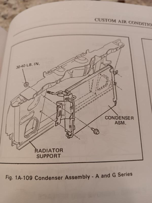

I have a 1972 J model car and I'm looking for info/photos or diagrams of how and where the condenser mounts too would be greatly appreciated... The car has the rad out currently,,, so assess to the back of the rad support area in front of the radiator is accessible...
If someone could please send some images or comments of the assembly or body manual (if there is a blow out of the assembly for mounting it would be awesome.. responses here are go but I've forgotten my password so accessing my profile to change the password would be great if a moderator sees this... To change it you require the current one and I don't have it as it's been a while...

This is from the 72 Service Manual. Hope it helps.
