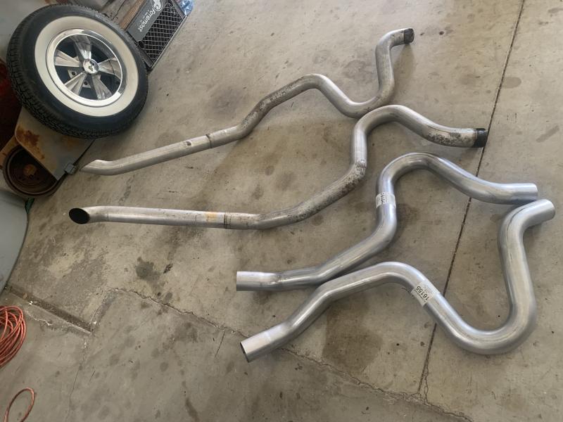

Originally Posted by ANDYA View Post
Building a 421 for my 65 GTO right now and plan on using Doug’s headers. I’m curious as to what exhaust system is everyone using with headers and still be able to use the factory looking exhaust splitters that exit behind the rear tires.
I have a 2-1/2” Flowmaster H-pipe system with 17749 Dynomax Super Turbo mufflers. I had another set of tailpipes that I used because it was impossible to separate the turned down tailpipe extensions from the tailpipes.
I fabricated the 2” splitters and bought some reducers that I had welded to the splitters. Then I was able to position them at the angle that looked right to me, the hanger clamps retain the splitter tips. I had bought some reproduction splitter hangers that ended up working nicely even for my non-stock parts.
