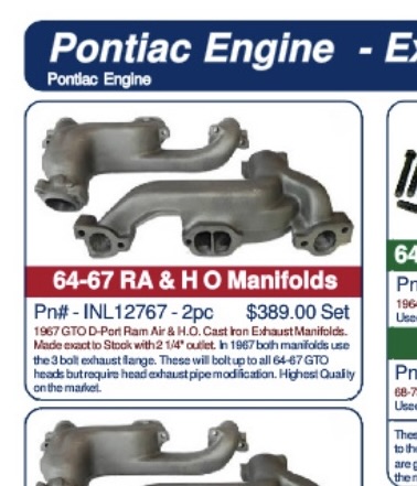

They aren’t all that rare, unless you’re looking for originals. They’ve been repopped for DECADES. So if you’re patient and are able to wait, you’ll likely be able to find a used set priced reasonably. Have you placed a want ad here on the forum? Not sure if Inline Tube has these in stock or not.
