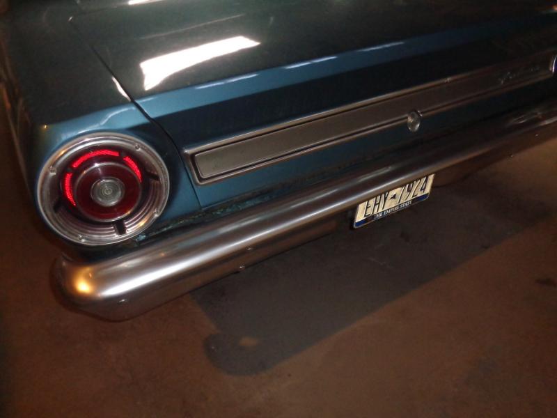

Is Cosmi-Chrome still in business? The local franchises around me are all gone. I had used them for my Falcon's bumpers a few years ago. They looked great, but only until winter got here, since I drive it year 'round.

Default Photo
Rear Cosmo-Chromed bumper (prior to winter salt bath).
