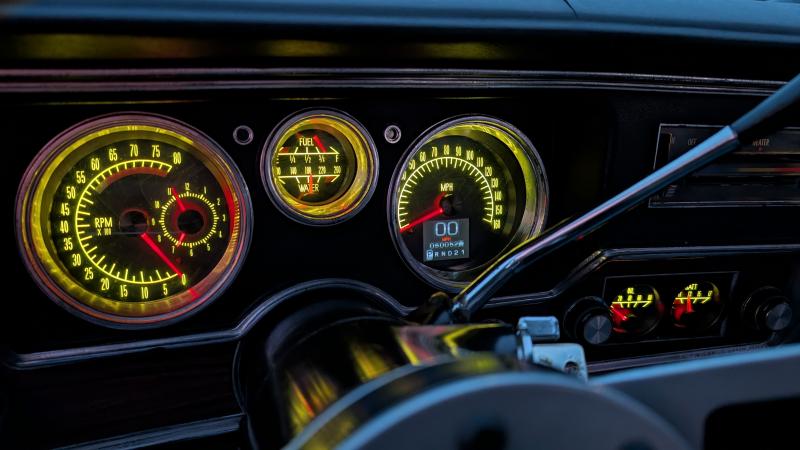

Hey all, I thought I'd share my custom Dakota Digital gauges in my 73 LeMans. The main three gauges are basically the RTX-70P-FIR system for 2nd gen Firebirds built into the can of my OEM gauges.
I also 3D printed a bezel and housing to add the last two gauges into the radio opening (it wasn't working anyway).
