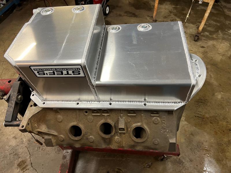

I wanted to follow up on this post with my Pan, its a Stefs 1240 full kickout, and a little different than the 1730 shown.
Inside looks almost identical to the 1730 from what I can tell:
BOTH of the pans listed here will need clearancing for a Titan Oil Pump, I borrowed these photos from someone to show the cutting/mods needed to clear the pump. I sent an email to Stefs to let them know and so far they changed their description on their website, but haven't made any pan mods to remedy this issue.

Another Tidbit of Info on these pans, they do take a little massaging to get things to fit correctly. I had to cut the tangs off the BOP 1-piece pan seal I used in the rear of the pan, but that is typical.
One bigger issue was my Billet front Cap needed extensive polishing to remove the sharp corners shown in this photo, I didn't take any after polish photos but it was almost rounded to the stud washer if you know what I mean.
Areas to be modified:
Even after removing the material, I used a ball peen hammer and pounded the inside of the aluminum pan outward.
Oh and I also had to clearance the lip on the bolt in windage tray as it contacted my counterweight in that location. With anything aftermarket, expect fitment issues to be worked out. I also had to modify my screen so that my dipstick would go through, no photos of that either.

The 1240 is squared off where it would hit most factory crossmembers, the 1730 is clearanced by having tapered front portion of the pan for fitting most Factory crossmembers.
I would honestly say the 1240 is more of a Chassis Car pan than the 1730, which was probably developed for more Super Stock racing.
1730:
1240:
