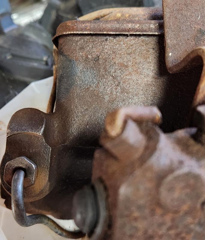

This one is stamped a little different with the cs last so it`s either 319 day of 70 or 190 day of 73 and it has bleeders. Thanks for your help.

Old 01-24-2026, 02:01 PM
Held for Ransom's Avatar
Posts: 9,583
Yup, July 9th, 1973.

So, when did they start with the small stamping with the Julian date by the bleeders instead of the larger 2 letter code stamped on the front machined pad?
Old 01-24-2026, 11:18 PM
Posts: 9,583
I would say 1973 model year, for sure. Maybe 1972, but it would have been the end right before the strike.
