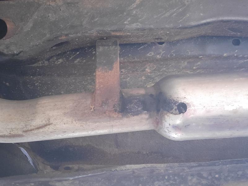

After cutting off the tips, I loosened the rear hanger to see if I could lift the tailpipe into a "stock" position. It was solid so is staying where it is for now.
Next question was whether I could get away with a straight extension pipe.
The drawing Scarebird shared (thanks again) gave me a target: top of pipe wants to end at 4-7/8" below the top of the frame.
I strapped a stick to extend the pipe and measured from top of frame:
Amazingly, the pipe is pointed pretty close to where it needs to be so I will order some clamp-on extension pipes.

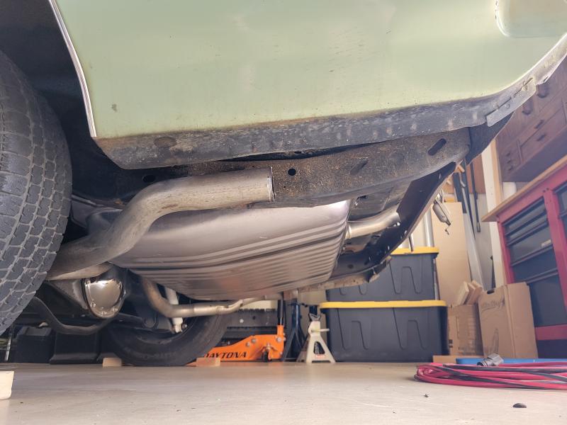

Mike,
Here are my tailpipes on my '70 Tempest. I think they are the old Torq-Tech 2.5"mandrel pipes with the non-GTO turn downs. They use the factory hanger locations. I hope this helps.
Dennis

Yours look like the tail pipes ride high at the frame like stock, then turn down before they reach the valance with tips cut parallel to the ground. This probably lets them use a stock rear hanger design.
Many of the aftermarket systems I find on Summit appear to be "universal" for 68-72 a-bodies and either exit straight back or to turn-downs like yours.
None of them match the stock design that Scarebird shared, which end at the lip of the valance and are cut at an angle that visually follows the valance line.
I have no idea where mine came from but they hang lower on the frame than stock and/or yours.

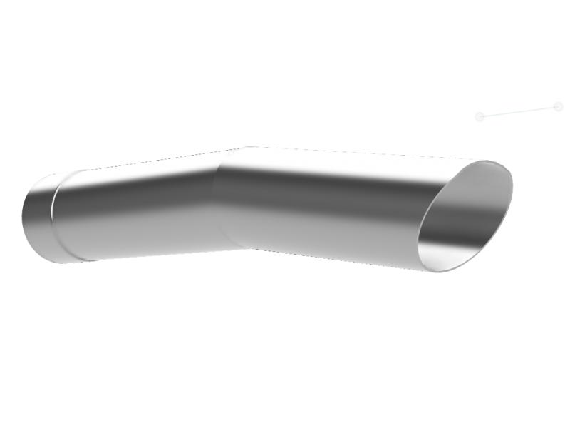

Inline Tube sells a 2 1/4" tail pipe with turn down. . Picture shows a GTO dual tip exhaust but description indicates a turn down at the valance.
The set I received from them had the correct angle cut.
https://www.inlinetube.com/products/plx70t2
Thanks for sharing this. Good to know there is a source for these!
Wonder why they chose not to illustrate?
