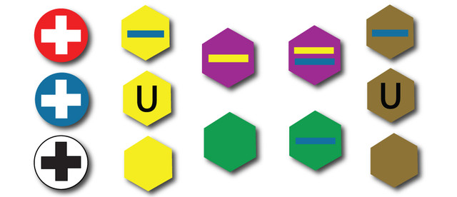

As far as this "little known secret" goes, the secret isn't accurate.
Formerly I was a driver that drove fuel tanker for a few years before I retired, this statement isn't entirely true. While some stations do mix the premium and regular fuel at the pumps to make the mid grade, there are also many stations that do have 3 gasoline storage tanks, and the mid grade fuel is blended at the loading racks as it goes into the tanker. It isn't cut and dried that all stations don't have a third tank for mid grade, and they're blending it onsite. The tanker usually has 4 compartments so they can transport 3 grades of gasoline, as well as diesel.
The code for underground mid grade fill cap is a blue background with a white cross in the center. The premium is a red background with a white cross in the center. Regular fuel is a white background with a black cross in the center. The fill markings for gasoline are on the far left.
Can't believe everything you read on the internet.
