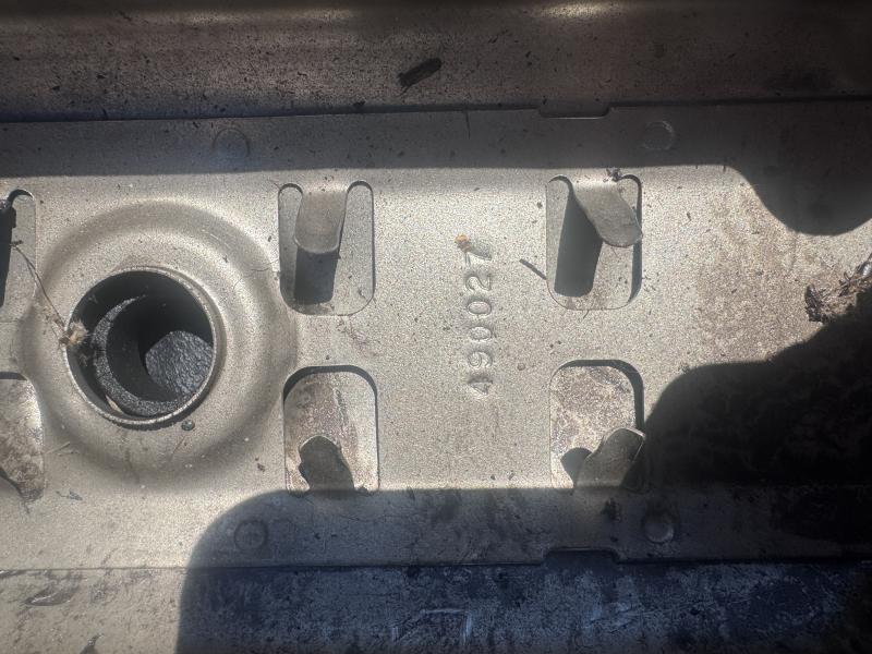

Oh hey I got these at garage sale just curious if they are for a 68 firebird and the value of them lately

No on the 68' Firebird application. Those are later chrome valve covers with the drip rails inside, which the early ones didn't have. I would say those are 77-79' valve covers

Chrome cover came on ALL 64 to 79 4 bbl or Tripower motors with the exception being the 73/74 SD 455.
No 2 bbl motors ever came with chrome covers.
Your covers there are the 73 to .79 covers with the built in oil detectors as opposed to the 67 to 72 bolt on oil detector types.
Go on the Franks Pontiac site to get a idea on the price.

Dont think I have seen those before. Looks like a RH and LH part number? Or you just need to pay attention when you install them.

right on , thanks everyone. Looks like Frank has them for $50 USD
Pair 1972-79 Pontiac V8 Chrome Valve Covers $50. Nice condition. Several small dents. Built in oil dripper type.
Don't think any 71 through 76 Pontiac engines came with chrome valve covers from the factory, 4 bbl or otherwise. They returned with the 77'-79' "TA 6.6" engine option in 1977 -79
Sorry, but I believe you are wrong.
I cannot say for the pre-1967 motors, but for 1967-1970 they came on the GTO 'L78' 400/4bbl (shared with the Firebird 400), and all the 'Ram Air' engines;
All these engines came with a chrome dress up kit, which combined the valve covers and air cleaner lid.
After 1970, the chrome valve covers were no longer factory installed, and were only available over the counter as an accessory item.
Then with the mid-1977 W72 engine option, chrome valve covers came back;
They didn't have the same type of high polished chrome used on the earlier units;
The W72 valve covers had integrated oil drippers, and a (?)pebble finish chrome plating.
To clarify;
Between 1971 & 1976, NO engines left the factory with chrome valve covers.
For 1977 & 1978 the non-W72 engines also did not have chrome valve covers.
Some dealers would prep vehicles with accessories to help make additional sales, so some people may argue till their blue in the face that their (fill in the black) came with chrome valve covers, but they didn't get shipped out that way.

So , do we feel mine are now pre 70’s?

Those with the built in oil drippers are from the 70s. Pre 70s had a separate part to direct the oil to the rocker arm pivots.

My ‘76 400 Trans Am came with painted valve covers, with the built-in drippers of course.
The chrome dripper covers came later. The chrome quality on the dripper covers was quite poor compared to the ‘67-‘70 non-dripper ones that are currently reproduced.
I used to buy 455 engines, all were 4-barrel (2-barrel 455s were rare) and not a single one had chrome covers. All were stock original untouched engines.
All of those special round-port ‘71-‘72 455 HO and ‘73-‘74 455 SD engines had painted valve covers not chrome. Those are the ones you certainly would think had the chrome covers but no.
