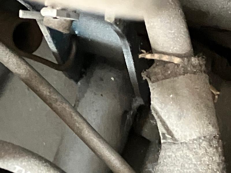

Default spring
the last time I will try to post pic

This is the best pic I could find when researching for my 66:
Name:	Return Spring.jpg

Default Return spring

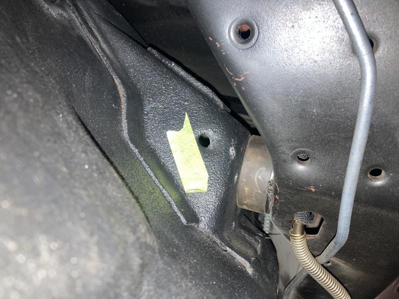

I think I’m good. Now if I could get the measurement of where the hole goes on the Z bar. Either measure from tip to hole or up from the tube. Is the hole on flange of bar or the flat surface? My bar must be aftermarket. No hole.

The hole is located 4" down from the center line of the push rod see pic looking down from my fender well. Second attachment is a snip from an electronic copy of the 66 Tempest Shop manual just for your info.
