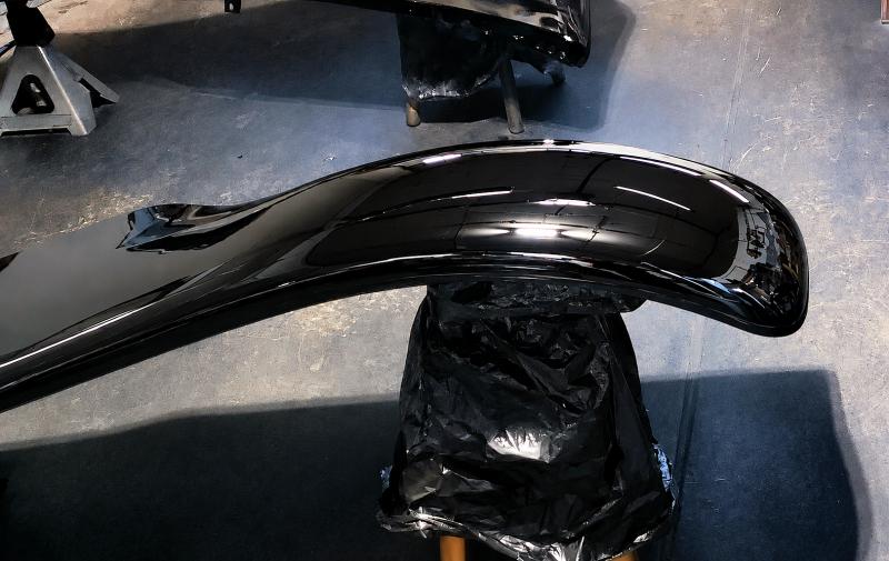

Regardless how smooth the paint is after spraying, there will be specs of dirt or urethane waves that can be corrected. I sprayed 4 of these fenders last week with 4 coats of SPI single stage black. They almost look good enough to put on the car, but I'm still going to sand and polish them, because there is some waviness at the rear that I can fix with some wet sanding. Urethane paint can get wavey as it flows and starts to cure, unlike the old 1k paints that when built up heavy, flowed smooth until they air dried. I'm sure in 1929, these had plenty of orange peel. I appreciate originality, but people are more critical these days. When I'm finished, these need to look like glass. Anything less and it'll appear like I missed the mark.

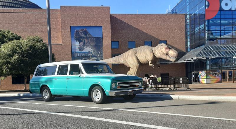

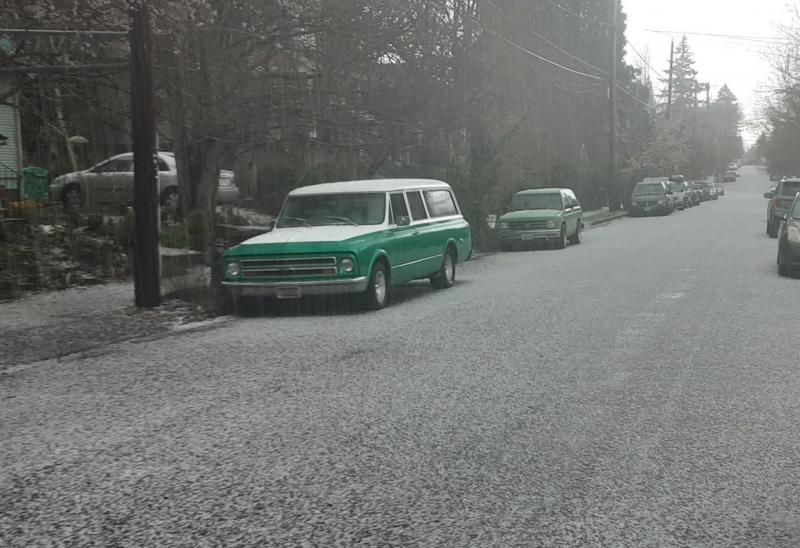

Since 2000 I've had 6 vehicles painted. Five of them along with my 2009 Ram 2500 with factory paint, had the clear coats fail around the 5 year mark. None of them lived in a garage. Here in Portland Oregon there's less UV exposure and more rain days. 🌧
The 6th vehicle I painted is my Suburban I had painted it with a single stage PPG metallic. After 10 years it still looks great. Never again will I have a base coat/clear coat paint job!

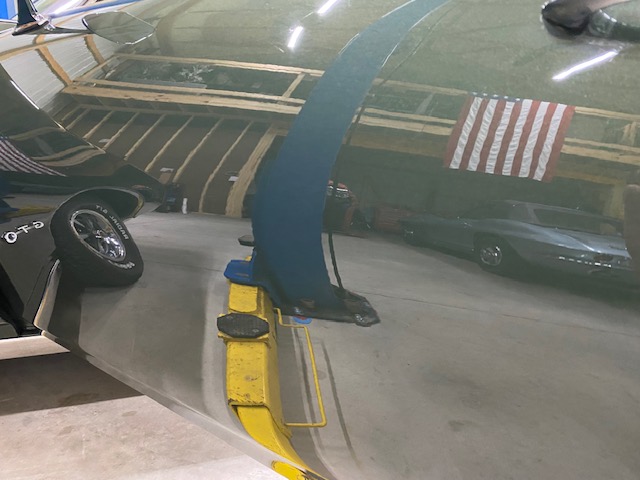

This was painted 6 years ago midnight green single stage metallic.
