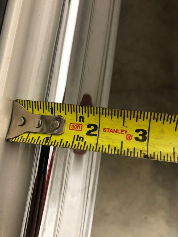

johnta1 02-27-2024 09:02 PM
Never new the 73 were different .what was the reason
The 73 Firebird bumpers were spaced about 1" further away from the body for collision protection.
(if I remember correctly)

71GP76TA 02-28-2024 01:17 PM
2 Attachment(s)
'72 and '73
Attachment 629494
Attachment 629495
