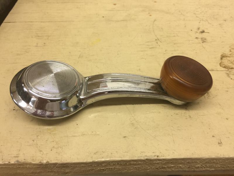

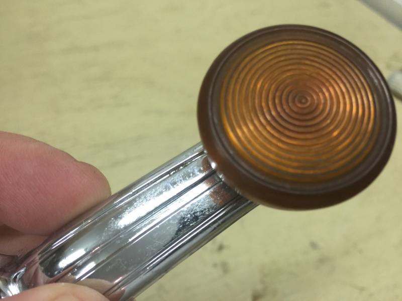

455hota 02-22-2016 02:16 PM
3 Attachment(s)
Attachment 421734
Attachment 421735
Attachment 421736
I guess this is the original handle that came from my 70 TA. Too bad there was only one when I got the car.
I guess the big hunt is on now....
marxjunk 02-22-2016 10:18 PM
that is the right one...neutral and the flat arc
heres a hint..if the crank casting number starts with 200 number its wrong.. and will have a true clear knob..and the curve is so big..it sticks off the door panel an inch..
