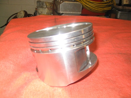

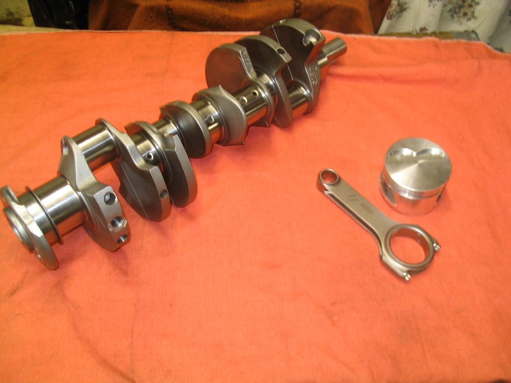

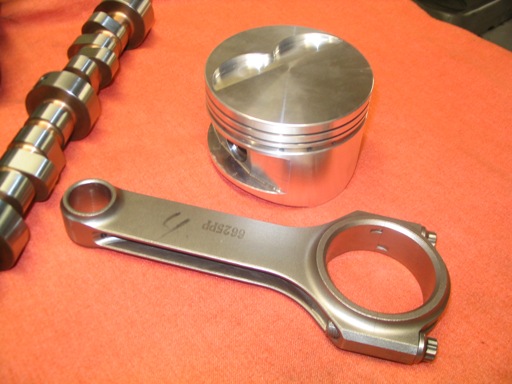

Eagle rods in a stock lenght with a Aries custon made piston, Those slugs are very light. Full floating wristpins.

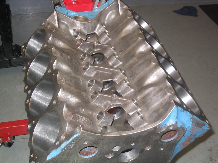

I reccomend polishing the lifter gallery area, I spent a frw hours on mine but it is verry messy, I have seen them look like a mirror before

A shot of the Crank original Nodiular Iron Crank .020 under rods. .010 under mains. Indexed and dementionalized. I suck at spelling!!!!!!! Had to remove a lot of weight cause of the lighter pistons.

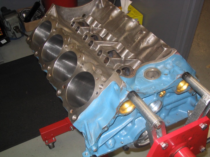

1971 WT Numbers matching block, I deburred it and removed any flashings on the block.

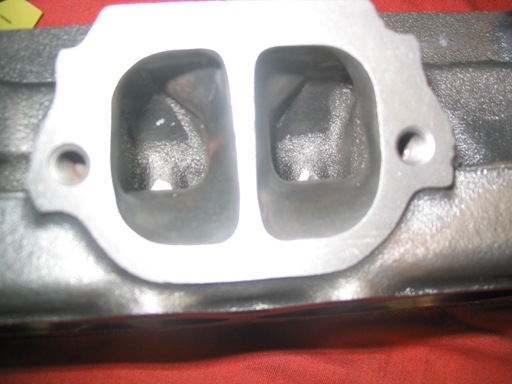

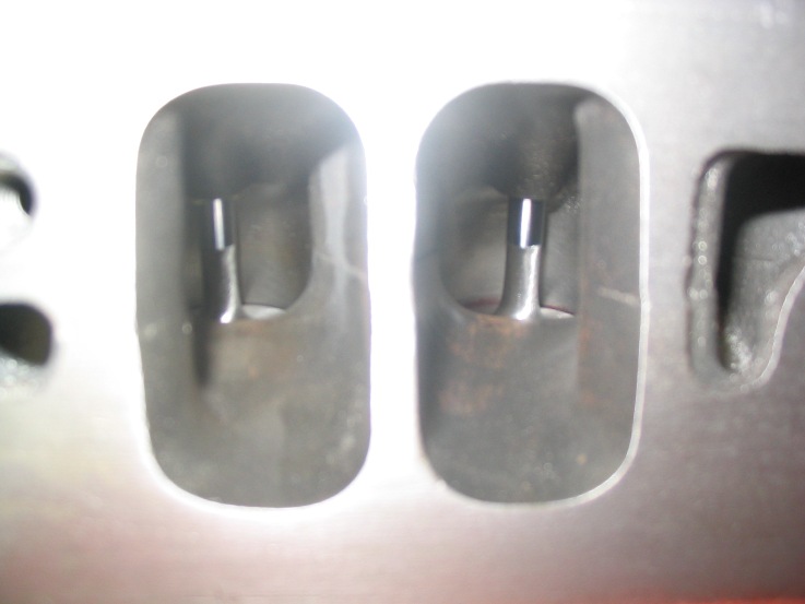

Exhaust Ports tha have been ported and polished, 2.110 &1.660 stainless steel valves pretty light valves ones too.

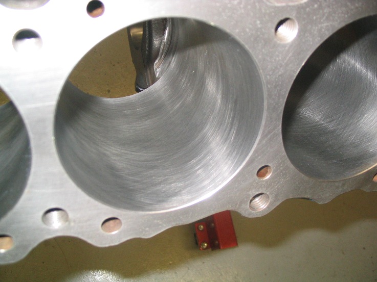

Crosshatch Pic

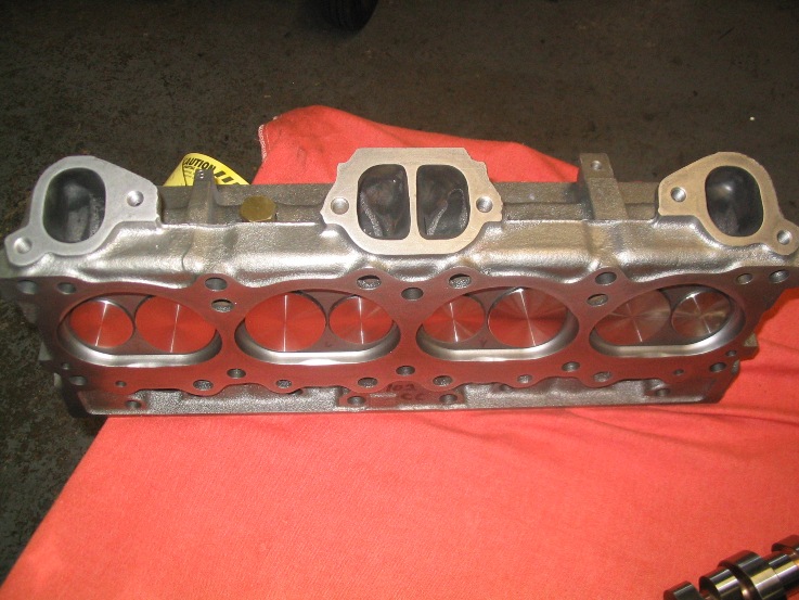

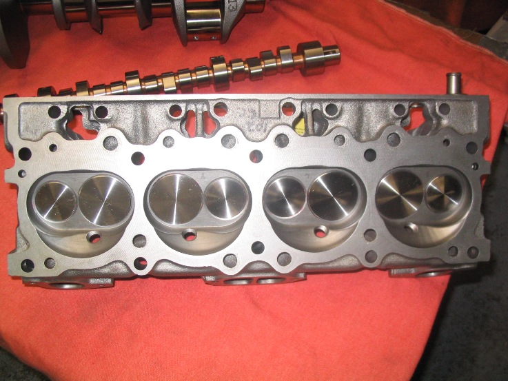

A pic of the combustion chambers, chambers are exact same cc's at 102 chambers angles have been"smoothed out"

Intake Ports Smae work done.

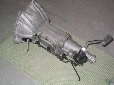

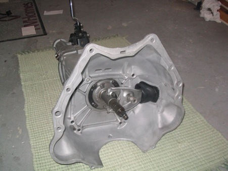

1971 Original M-21 That I rebulit thats gonna go with my engine, I will be using the stock flywheel and a centerforce dual fiction clutch assembly.

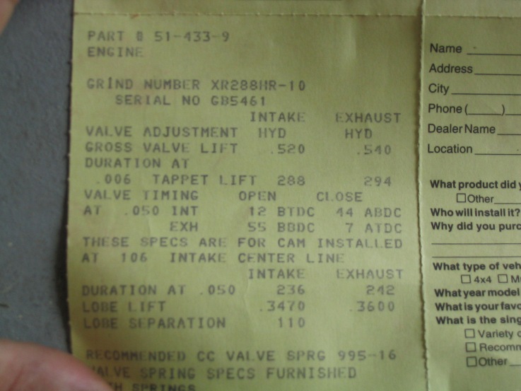

Comp Cames XR288-10 Hyd Roller Cam

Close up of the Piston, I am using a Total Seal Rings.
