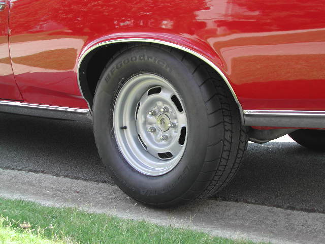

What wheel back spacing?

Blue,
Thanks for trying to post these pics. I'm looking forward to seeing them. I can't imagine how those 30 X 13.5's could possibly fit on my car without some serious fender surgery, or keeping the back end jacked up with the air bags.
Here's mine with the 275/60R-15 BFG-DR's. The picture makes it look like there's more clearance than there really is.
