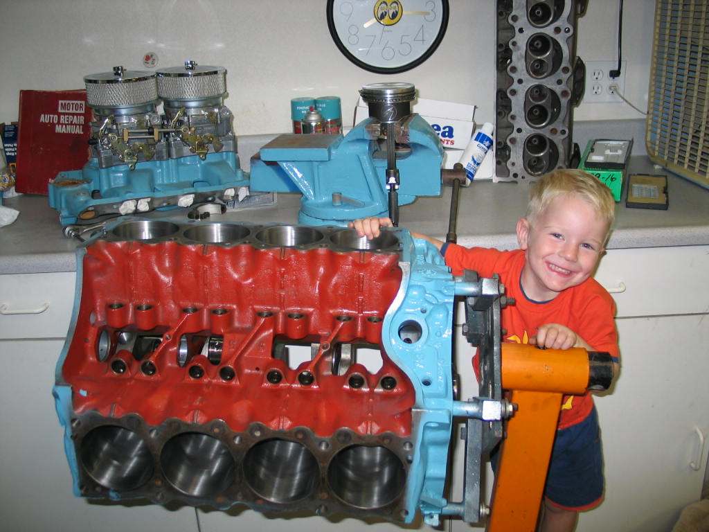

I'm swapping out the 61 2bbl 389 for a 73 .060 455. So I should be about 469 cubes. Here's a few pics of the progress

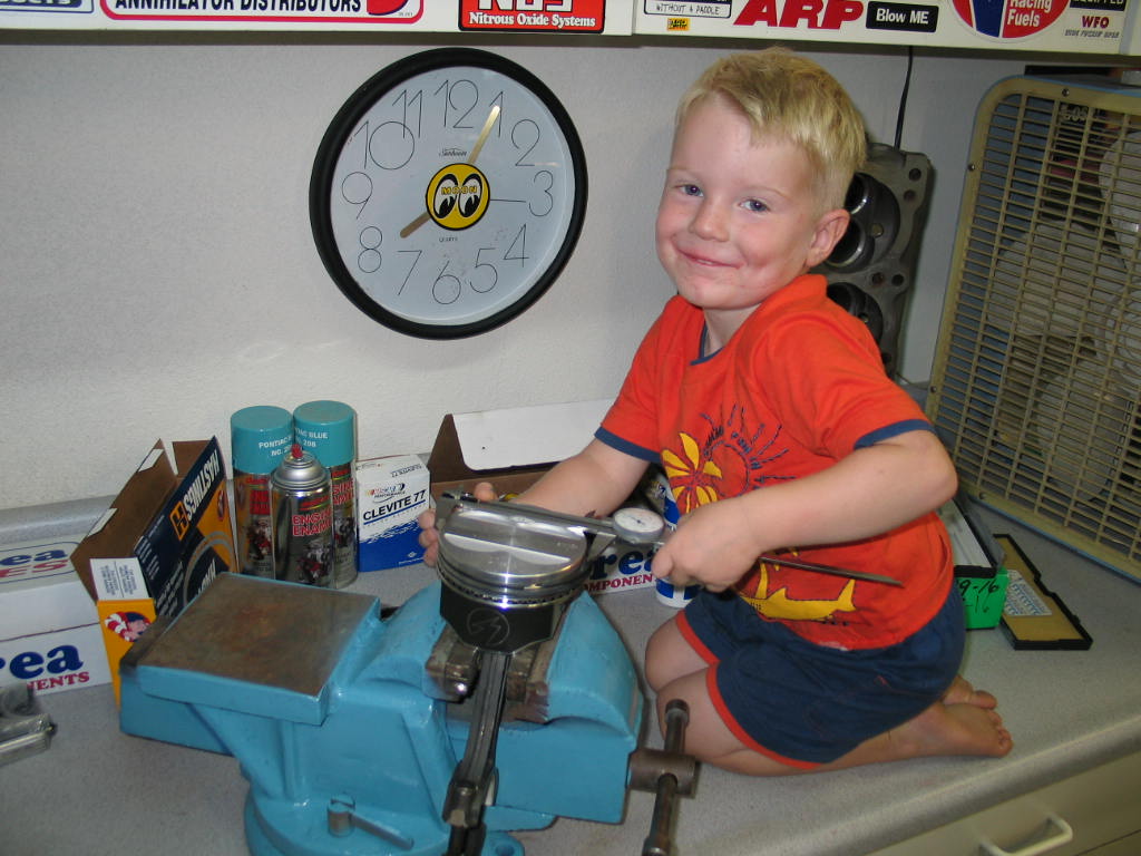

Old 07-25-2005, 02:53 PM
SupergasDil's Avatar
Posts: 2,719
Here's one with the good stuff sitting on the counter. I'm going for a Super Duty look.

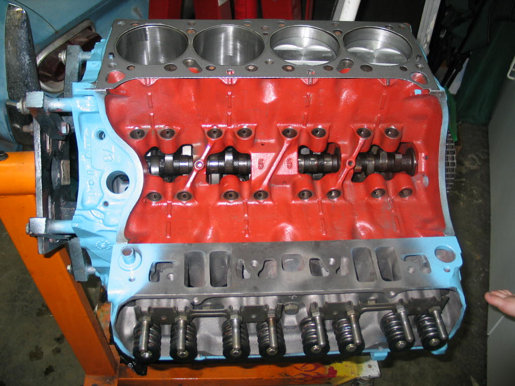

Old 07-25-2005, 02:56 PM
Posts: 2,719
Here's one with the slugs and crank in. The cam degreed in perfect and didn't need an offset key. I was lapping in the valves and putting the heads together in this pic as well.

Oh yeah, how do you like my early Pontiac vise?
Do you notice anything special in the first picture besides my boy learning to use the calipers

Wide parting line indicating your using the early forged rods.

You got it. I used the rods out of the "61" 389. They're a little stronger than stock cast and didn't cost any extra. Since the car will be a stout cruiser I wasn't worried about using them.
