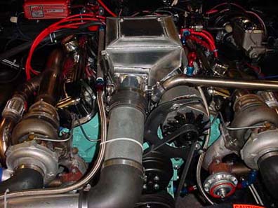

For a throttle body you can use a Ford style from Accufab or BBK but it will need an adapter. These throttle bodies are about $200 from Summit. I made my adapter out of 1/8" aluminum plate. This way I was able to fit my modified Victor manifold under a stock Turbo Trans Am hood.
I'm using FAST fuel injection with a Ford throttle position sensor.

man that motor makes me dizzy looking at all the hoses and tubes! Pretty slick setup!
