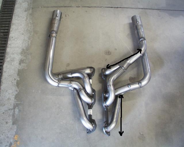

Ron whats the measurement that i have marked...I am wondering if these will work in my Grandville?

grandville455,
When the 3 un-coated sets arrive at my place tomorrow I'll take some measurements. Before I send them out to Turbowner(PY), Robert Williams(PY) & Chewey (TAC).
I'll post the measurement by tomorrow night.

grandville455,
Heres some measurements I took today. for the distance from the front to the crossmember. I used a starting point at the center of the 1st bolt not the end of the flange. Just in case one flange had a little more meat than another. 1st the O-ports.
drivers side;
Distance back 10 3/4"
distance down 10 1/4"
Pass side;
Distance back 11 1/4"
Now D-ports;
Driver side
Distance back 10 1/2"
Pass side
Distance back 11 1/2"
