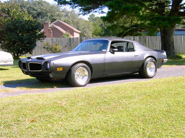

HAHA!!! You got bit by a flex fan!!! Now I don't feel like such a moron anymore from when I got bit by one 10 years ago. <HR></BLOCKQUOTE>
Hey how fast is the car in you sig? <HR></BLOCKQUOTE>
Not very So far the best I have got is a 8.5 in the 1/8 with street tires (2.2 60'). Most recent 1/4 track trip I was plagued with fuel pump gremlins and never got a good run. I need to stop chasing power and get some slicks. All I keep doing is compounding my traction issues. I'm actualy slower than 8.5 now because I have to let off the throttle before bumping 2nd or it'll break traction and never lock back up... this is after riding the break off the line just to keep from spinning on the launch.
The pics in the sig are old... here is a more recent photo. She's been lowered and has new wheels and tires. Right... I have traction issues so I go and lower my car But damn it looks better!
The pics in the sig are old... here is a more recent photo. She's been lowered and has new wheels and tires. Right... I have traction issues so I go and lower my car But damn it looks better! <HR></BLOCKQUOTE>
That is one good looking ride brother... but I have to say, with that signature "VTEC this" you and I may have to throw down hahahah! How bout it? If I win you change the signature? Hahaha! It's all in good fun!
I like that Matte paint too, kindof "rat" style.

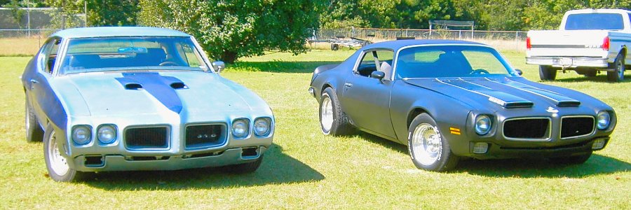

There's a couple here in the area that I can't touch... but they both have like $15-20k in their motors. The back window has white letters saying "VTEC THIS" as well... but the imports that can beat me are well beyond their days of VTEC, Type R, SSi,... whatever.
Remember... I am 8.5 in the 1/8 TRACTION LIMITED... if you want the deed to my sig then I promise you I will buy, steal, borrow, find, or make some drag slicks before we "throw down". The car has sub-frame connectors and line-locks alreay on it... so she's more than ready to respond to the stickey stuff.
What are you puffing your chest with anyways? Unlike alot of muscle car buffs, I admire many of the Imports that are done right... it all the rediculous sticker/coffee can econo boxes that drive me up the wall. My previous neighbor had a new Evo. That car was really nice... too bad he couldn't catch me on the track with it.
BTW here is one more shot of her along side a buddy's 70 GTO. Both are HO cars.
