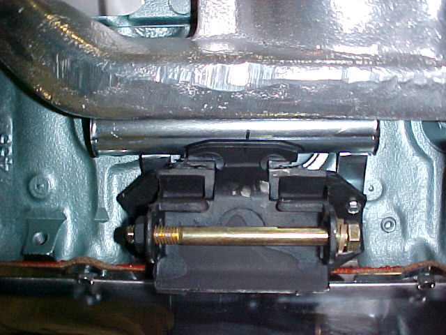

Here's a better picture from my engine just completed and not installed yet.

Thats excellent! I should be able to complete
everything tomorrow. I need to disconnect the
starter wires, run the battery pos & alternator
down the front. The hot ignition wire can go straight down the back. The tube as you say should hold it's self up. Your photo was perfect! Thanks for the help!!!
