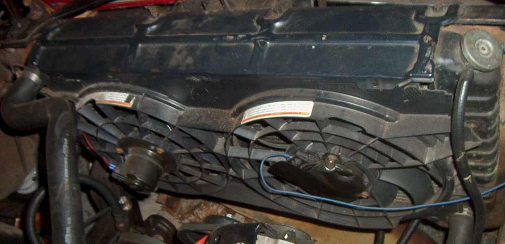

My set up is a Champion alloy radiator (firebird specific) set up in a custom alloy shroud/mount that I designed to suit the fan pack I'm using.
Fans are a dual set up out of an early 2000's Ford Falcon (full size sedan here in Australia)...they move a lot of air.
Controlled by a Derale adjustable controller.
Controller (top right on the rad support)
