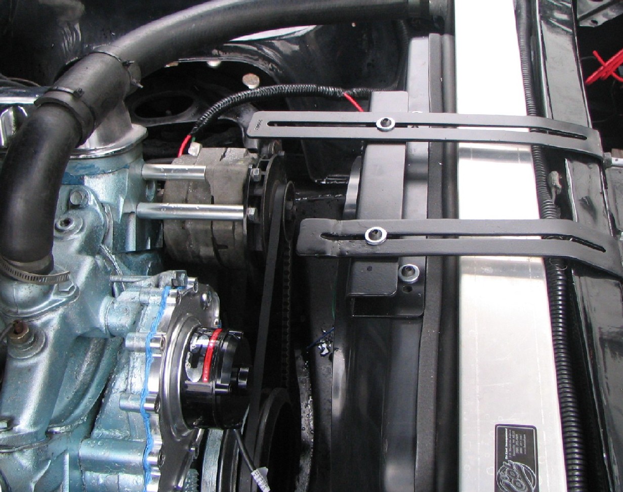

Here is a pic that shows the CSI waterpump, the fan assembly, and the relocated alternator. Note that my car has manual steering (as God intended, for MEN's cars).
The top (driver's side) upper shroud bracket is stock, the left one I trimmed down. I've since trimmed both (and the lower ones) and neatened them up. There is another bracket that connects the long brackets to the shroud itself. If you look closely, you can see that I redrilled this other bracket's mounting holes. This moved it over enough to allow me to use the existing bolt mounts on the core support (I had to use bolts that were about 1/4" longer).

Hey Lee you got enough blue silicone on that pump??? :P A nice even light coat works just as good hehehehe. Just jiving ya man, I like the fan set up. Hows that pump do on the street?

I'll have to post another picture, with everything neatened up
The pump works VERY well on the street. In traffic/low-speed/idling situations, it works MUCH better than the mechanical pump.

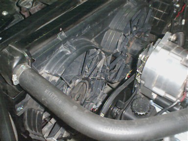

I finally got around to installing my '95 New Yorker fans on my 'Bird today. A little more work than I thought it would be. I had to do very minor trimming on the corners of the shroud to get it on the radiator nicely, and made some brackets that mount to the rad. support the same way that the radiator does.
I ran each fan on a seperate relay and switch so I can run them independently. I also used 2-way rocker switches - up is "on", middle is "off", and down will "on" and ran through a coolant temp. switch (temp switch will be installed later).
Pics......

Nice install chicken, going to call around and see what I can find tomorrow
