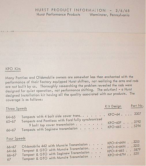

Hurst made aftermarket linkage kits(rod & levers) for all of the transmissions that the Pontiac A-body cars used.
Peter Serio
Owner, Precision Pontiac
Peter Serio

More Hurst info:
