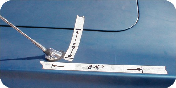

I'm doing the same to my '66 Catalina. 66SSE e-mailed me these pictures of the antenna location on one of his '66 Bonnevilles. I still haven't got to it, but these should work great!

And the other one.........

Guys, thanks a million. Those pictures and the advice is just brilliant
I'll be doing the job on Sunday.

Even I could understand a pic like that. Good job 66SE
