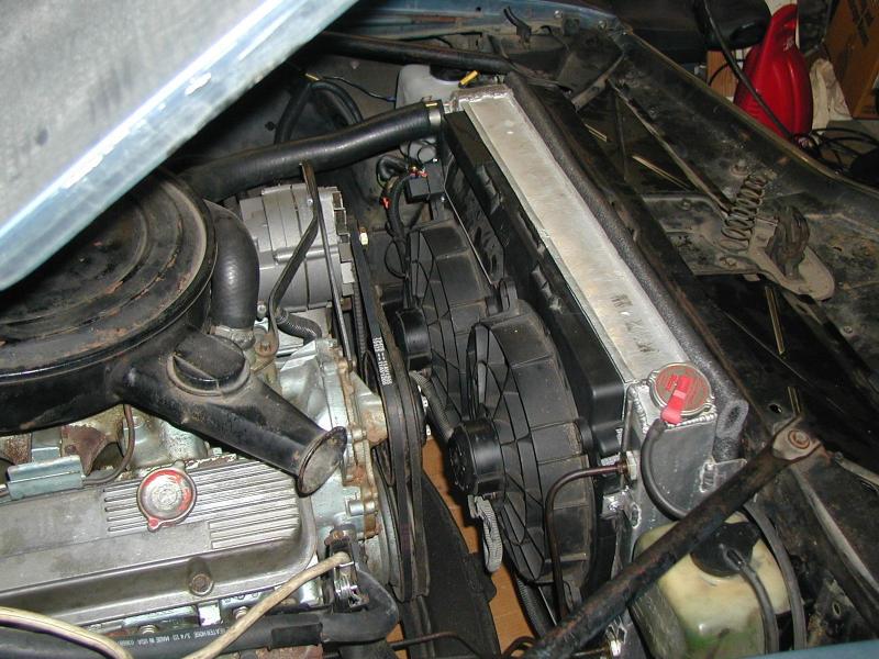

I've modified a pair of 97 TA LT1 electric fans to fit my aluminum radiator. The darn thing stays at 190 and won't move any higher. I'm also using a thermal switch and relay setup made by hayden. If you look at the pics you can see the brackets and sensor fitting I had to weld in to accomodate the fans. I've posted some pics of the install here.
