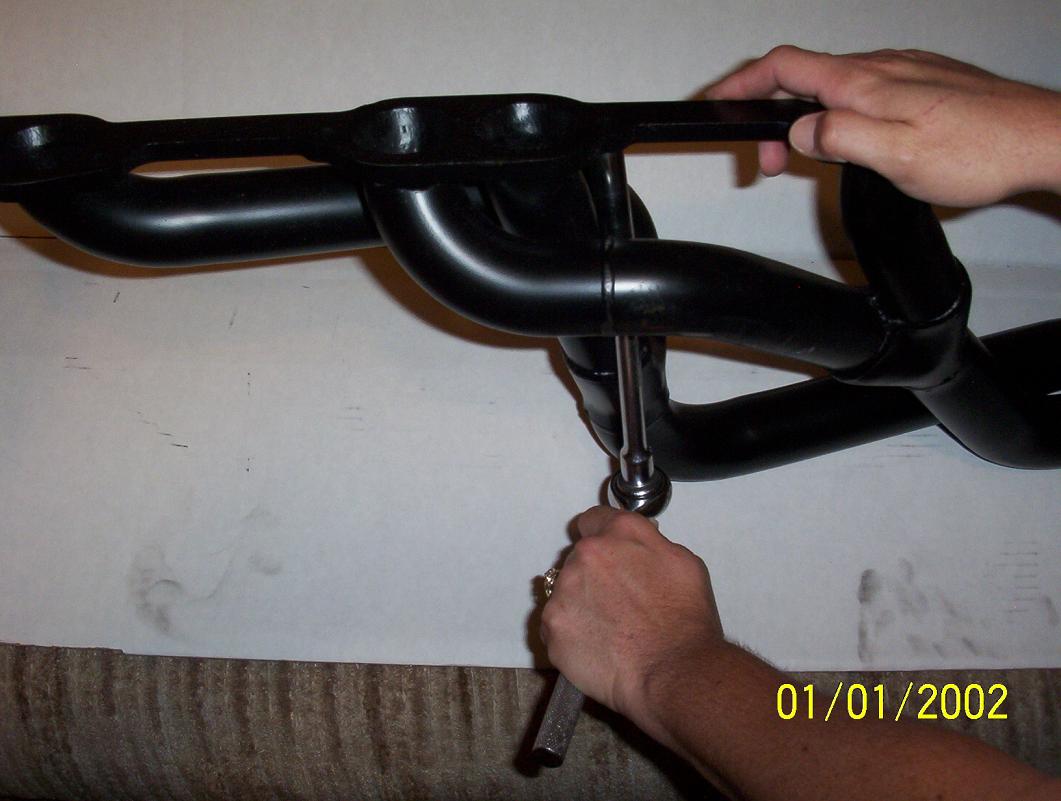

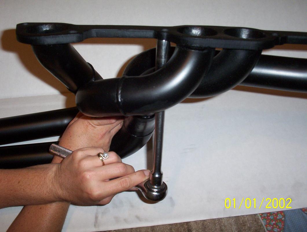

ta-dude had asked about the access to the header bolts way back on the 1st page of this thread. Thit pics I posted on the 1st page were the 1st I ever posted. So I'll try to remeber how, but heres pics of all the room for a wrench & a socket wiyh an extendion.
On the O-ports you can easily get a socket & a wrench on both # 5 & 6. On the D-ports you can easily get a socket & a wrench on the # 5 but only a wrench on the # 6 easily.
The pass side D-port[img]100_1668jpg[/img]

  #134
Old 09-19-2004, 04:59 PM
TUNNEL PORT's Avatar
TUNNEL PORT TUNNEL PORT is offline
Join Date: Jul 2003
Location: Napa CA.
Posts: 571
D-port drivers side
