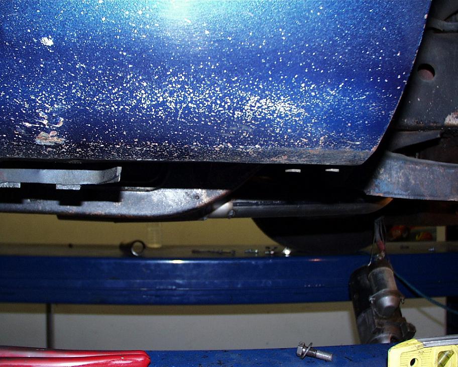

Ground clearance with 3" collector
Old 07-13-2004, 06:05 PM
briann briann is offline
Posts: 349
That is excellant!
