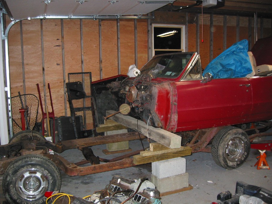

Now what

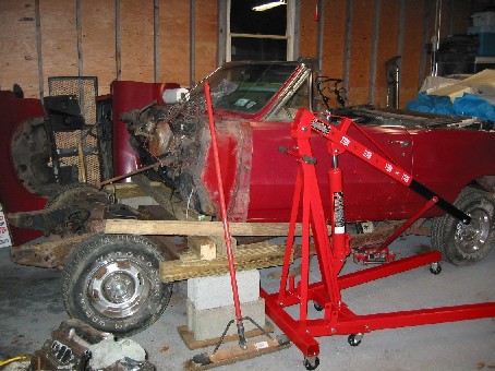

Just need to figur out how to jack the back up and the body will be off.

pul the trunk lid and empty the trunk out, then place a 4x4 under the top of the 1/4's and use the engine crane sitting by the car in the photos. the back 1/2 of the car doesn't weigh much and will come right up with this method.
to answer a previous ? re the body bolts. one will come out just to give you hope, the the rest of them break off just to frustrate you.
that's why i didn't pull the body on mine. the mounts are still in decent shape and i want to drive this car again before my kids have their licenses.

Thanks for the info. The frames is rusted so it has to come out. Good idea about the 4X4. I will be setting it up on bocks tonight.
Wish me luck.

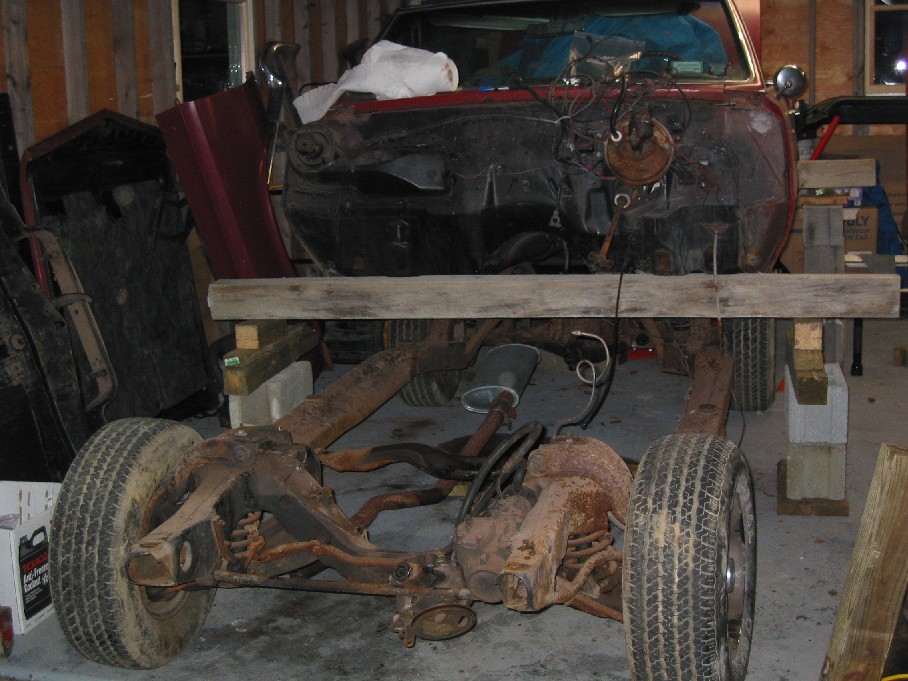

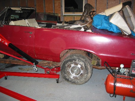

OK found some big wood and jacked the body off.

slowly sliding the frame out

Frame completely out. Now the real fun begins!

You will need to weld braces across the top of the door openings so the floor pan does buckle when the doors are off. John

Don't take this the wrong way, but the way you have the body supported doesn't look good. Why would you use a 6x6 and only use a couple of inches of it? It looks like it is tipped sitting there. You really need to crib that blocking and get more of the 6x6 under the body before it comes tumbling down.
If you take the 6x6 and place underneath the rocker panel you will be better off. The blocking should be a cribbed, it will not take much of a bump to have your dreams or your life come to an end.
The car body should be supported under the firewall and in front of the rear wheels. Take a look at my site to see what I am talking about. Not that mine is anymore elaborate than yours, but you can see where I placed the posts. I had my body in the air like that for nearly 13 months, did the trunk, the center cross member and floor with it like that. Never worried about the thing rolling off the post or blocking.
