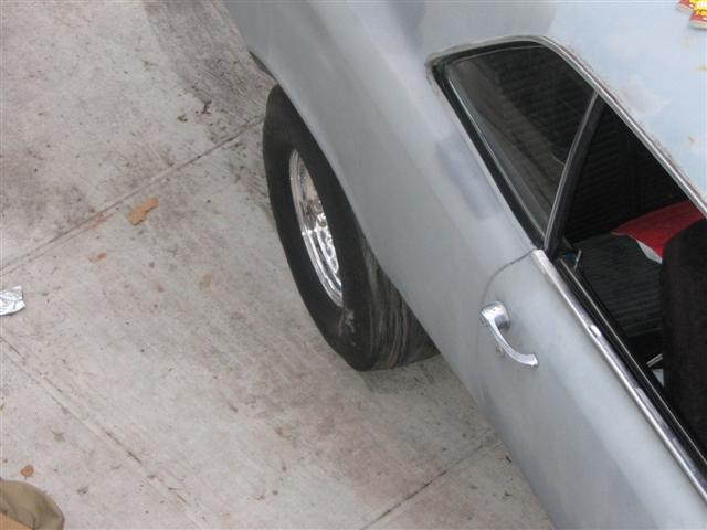

i run 15x10 centerline convo pros on my 66 gto...with 30x13.5 mt et streets...wheels have 5 or 5.5 inch backspace...i forgot...its been awhile since i put them on..

yea...i remember going crazy with the backspacing...i ordered 2 sets of wheels...the car has a perfect stance right now...i believe it is 5 or more...i will try to find out...i have about 1/2 inch from the inside of my tire to my chassis..i will take a few pics tomorrow and email them to you...

no mini tubs...when i installed new quarter panels on the car the lip that goes into the wheelwell was kinda big...so i had to trim it down...they fit perfect..i keep a little extra air in the rear airbag just in case...i will take pics today...

the tires fit perfect...give me your email address for better pics...i took a few..but they are showing up too big..i have a few different angles..the sidewalls are big on the tires...they are 30x13.5...if you wanted to have the quarter's cover the sidewalls, you would be better off with the 12.5s...when the car is level the quarters cover the top of the tire like a glove...

blue66....i sent you a few pics..hope they are good enough...if you want any other angles just let me know..you can really see how they look from the side in the photos i sent you...let me know...

I resized one pic that you can kind of see the tire in the wheel well.I will post the pic.Rob can you take a pic looking straight at the wheel/tire,slightly forward and the back?
