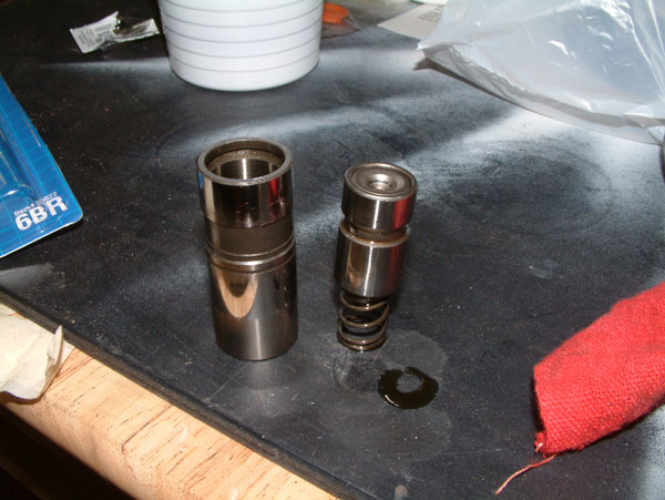

I THINK I have hydralic lifters after all....dont I? look at picture..would explain all the trouble I've had...boy I feel soooooo stupid

Thats a Hydraulic lifter. Go to zero lash then 1/4 turn more & lock her down.

Thanks for the compliment. Just check all the lobes to see if they have started to round. If all the lobes look good & the bottoms of the lifters do also put it back together.

You know I have been workin on pontiacs for almost 20 yrs now.......so truth be told... I AM STUPID! I have never seen a hydralic lifter that looked like this one...oh wellllll..anyhow the motor is back together and the HYDRALIC lifters are adjusted and all are quiet.This 455 really runs now!14 inches of vacum at idle and a lopey idle... did a small power brake in reverse...HOLY CRAP....almost took out the garage door.roadtest coming soon.
