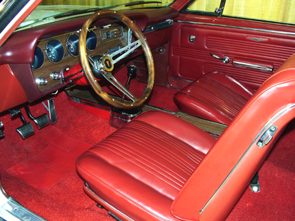

This isn't my car, but here's what the interior should like like, minus the aftermarket wood steering wheel:

Thanks Racerboy, that is what mine looks like also. Let me know about the paint.
