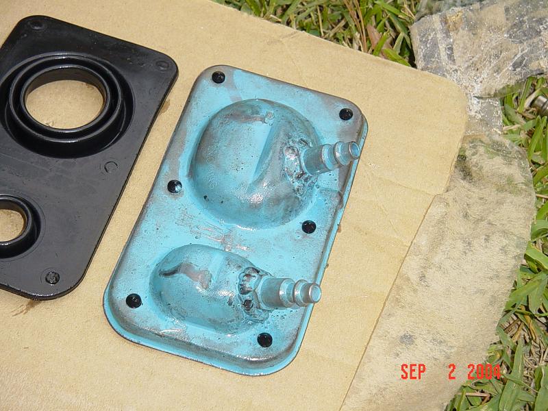

Frustrated at bleeding the T/A brakes, I stole a page from Car Craft. They made a fancy pressure bleeder from 1/4" steel and stiff rubber with a air fitting tapped and screwed into it. I figured the same could be done with a stock cover, and weld a fitting to it.
I wound up using two cover gaskets as the big (front chamber) tended to leak initially. After fitting it with a second rubber gasket, it only leaked a tiny amount.
I use clean dry air at 10 PSI as a source fitted to some old air fittings I won't use.
You can go down to the individual wheels rig up a container and clear tubing, crack the bleeder and watch the brakes bleed themselves.
I gotta say, this is one of the coolest things I've used so far. The only trick is to keep the reservoir filled as you will fill the typical "one man brake bleeder" container in about 30 seconds.

Old 09-02-2004, 03:48 PM
78 GHOST 78 GHOST is offline
Location: Houston, TX. USA
Posts: 2,354
Close up evidence that I need more welding practice.

Old 09-02-2004, 04:14 PM
Larry Navarro's Avatar
Posts: 6,369
...and you took the time to paint it blue?!?!?!
Now thats pontiac in your blood!

Old 09-02-2004, 07:55 PM
Posts: 2,354
"Necessity is the Mother of Invention"
I'm pretty good at brake bleeding by myself, and have bled the TA myself in the past with a one man bleeder kit. Laborious but effective.
Well, I got a chance to brush up on bleeding because the Front Left hose collapsed on me yesterday. Damn thing just about squirted off the road to the right.
Anyway, after changing all the hoses front and rear and the calipers, I simply could not get the danged pedal to come up. Tried everything, then remembered the Car Craft article and improvised from there.
Tom, I agree with you. It is definitely fast, easy and effective.

UPDATE:
DO NOT use 10 PSI as the pressure will push brake fluid all over the engine bay. Instead, turn your regulator to the lowest possible setting, maybe 2-3 PSI.. just enough to move the fluid.
This technique is essential in T/As as the steep angle the M/C is mounted makes it very difficult if impossible to mount the M/C after bench bleeding, without introducing air.
