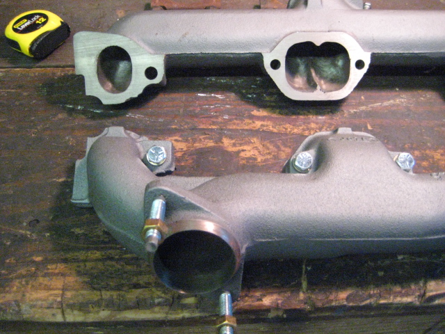

Mine arrived today as well B man. I did have a Question About log Manifold.
I decided to use 1423 felpro gasket. When I held gasket and manifold up to head
it looks like you see a lot of gasket when installed. Does anyone every cut gasket
once installed ? Just did not look right to me. Thanks again !

No gasket needed if both surfaces have been machined. I have never used one. But,those logs look like someone has tickled them a bit.

The steel shim manifold gaskets do have some additional material in between and around the ports but I've always left them alone. The gaskets came looking that way from the factory, the factory original look is always fine by me.

I've used the Felpro gaskets and have always had good luck with them. I usually trim them down with snips so that you can barely see them.

Yea, I got to looking around and I thought the 1423 was just for headers. Felpro does have another gasket Fel-Pro QMS9499SH , looks to have less material outside sealing area. But I think I will stay with 1423. And yes I have been on these logs for about a week but they already had attention when I got them. They are ready to install !

SteveOw- any "theory" behind your removal of the center ports divider?

Jack, that center port divider is another thing the Pontiac engineers changed their mind on- I've got a bunch of sets of logs and only a couple have the divider. I don't recall the dates on the ones with them or without.
The set on my Lemans right now are '70 castings that don't have the divider.
My 70 GTO got one of each!! Early Nov. 69 car,....... manifolds weren't that much earlier from memory.

Well I would assume that it would be easier to seal the gasket with the divider removed. I guess that I will cut them out when I open up the out port.

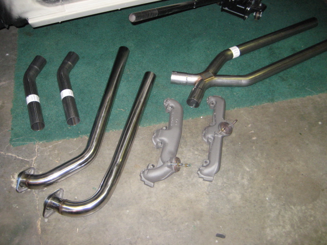

Nope, no theory. In my case the center was flaking off, like it was really catching heat, so when I started to polish things up it would just flake off like rotten metel. So I took it out. Now looks great, all polished up and I think things will flow better with it gone. One bad note, I am sending my pypes down pipes back tomorrow, the coller will slip right over the bell at the end of the pipe. When I tighten the coller to the manifold the pipe will just pull loose. It just pulls it over the bell when tightened. Anyone ever have this problem ? Very Disappointing.
