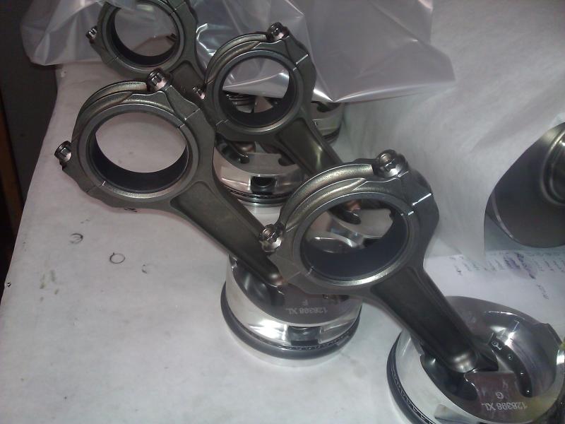

After resolving some of the issues with the original build, the RA-V is coming back together. Should be complete in about a week, waiting on a few new parts.
Slightly used parts from this historic build "fiasco" might be put up for sale to help finance the repair costs.
It's now dry decked and double o-ringed.

looks good!

So how tall are the "O"-rings protruding from the block deck and the head deck surfaces?
How thick of a Head Gasket (Assume Copper) are you using?
Tom Vaught
