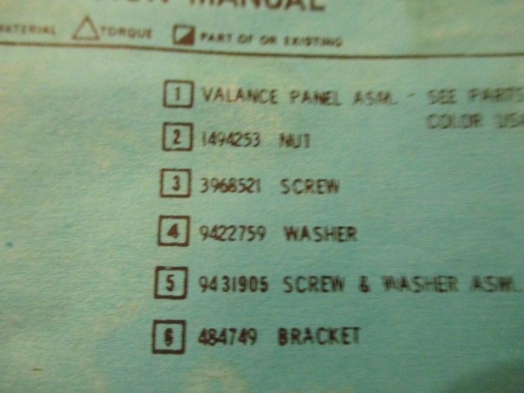

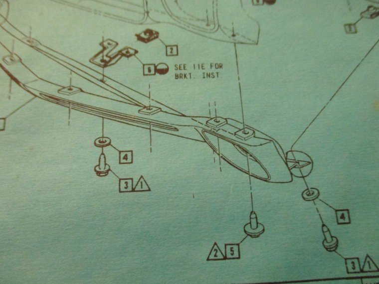

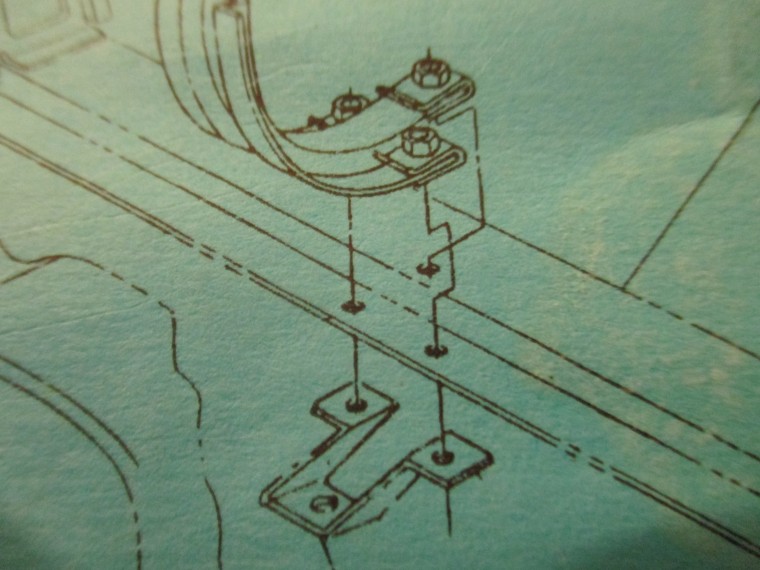

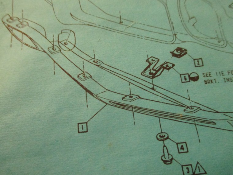

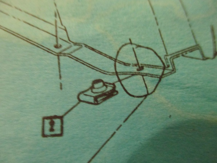

Default POLY VALANCE PROJECT
I LIKE THE 72 ASSEMBLY MANUAL FOR DETAIL..THEN LOOK TO THE PARTS BOOK FOR DETAILED INFORMATION ON THE HARDWARE..I PREFER A PAPER BOOK TOO..THESE DRAWINGS & PART #S SHOW DIFFERANT LENGTH BOLTS..BUT IN REAL LIFE THE ASSEMBLERS (AS FAR AS I HAVE CHECKED) USED THE COMMON #....314 INNER FENDER BOLTS USED ALL OVER THE FRONT OF THE CAR..ALSO SEE THE SPECIAL SELF TAPPING SCREWS FOR THE INSTALLATION OF THE VALANCE TO THE BUMPER..THESE SCREWS ARE ALSO USED ON THE GRILLS TO THE BRACKETS..AGAIN SAME HARDWARE NEAR THE SAME LOCATIONClick image for larger version

Thanks Glenn. What is the Sheet number in the bottom right corner of the assembly manual drawing?
