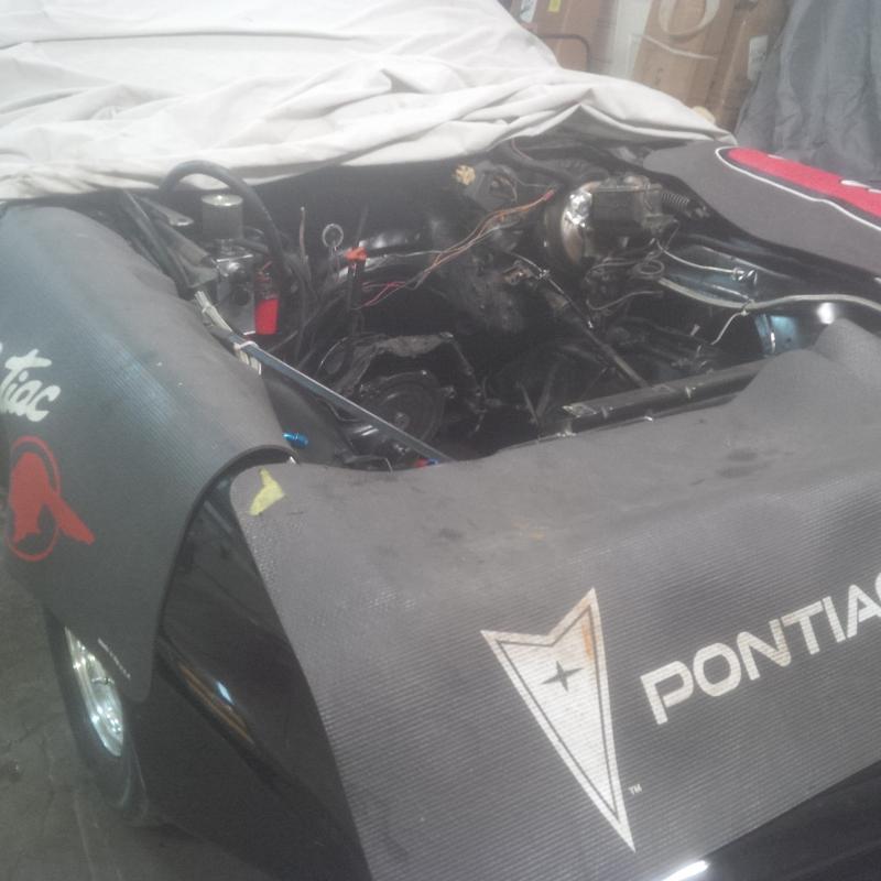

Update,Engine swap under way.Engine was pulled two weeks ago,heads and intake are at SD,rockers are at Harland Sharp for a rebuild.
Do tell about the surgery Dave is doing to the heads.
Not sure on exact details,more head flow,milled for compression target of 11 to 1.Intake being portmatched to the new head port opening.An honest 600hp is the goal with the same street manners,91 octane,900rpm idle and run in the 10's in the heat.
