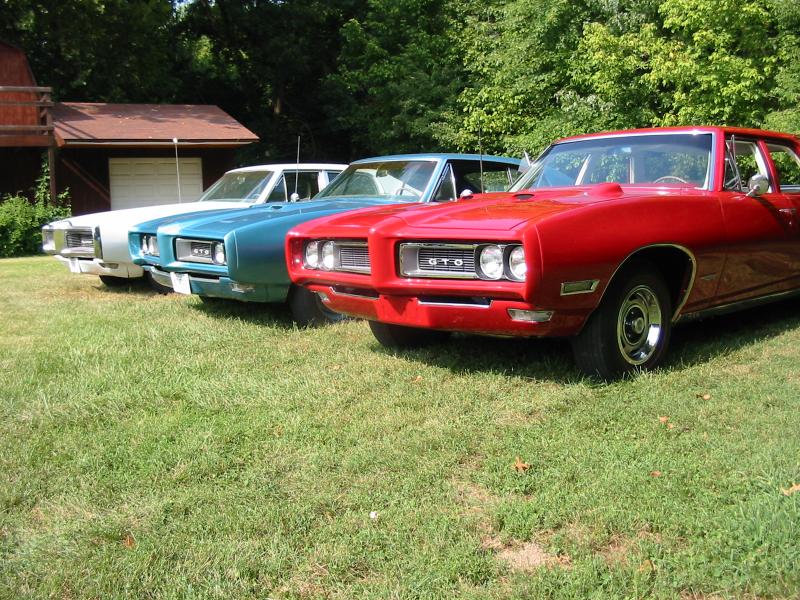

A couple of pics of the cornering lamps, you have to cut part of the core support away for the housing to clear. But the there is a template stamped into every core support.

Old 05-08-2018, 04:25 PM
They look more suitable to big cars and they look good on that wagon... I never cared much for them on GTOs.
Very nice collection you have there 68pongto!
Nice collection indeed 68pongto! Greg, we know the middle one is your favorite.
I agree and don’t miss them on mine, they just seem too large for that front spot on the fender.

Old 05-08-2018, 06:53 PM
Yeah, you know it...but I dunno..that wagon is pretty sweet too.
Old 05-09-2018, 04:54 PM
One of my 69 LeMans has them. Neat but I don’t think they add to the appearance of the car. I’m not crazy about them on the GTO where that clean fender (no front emblem) and matching color bumper looks better without the lights.
Interesting that the 68-69 A body cornering lights are basically a recycled 67 full-size option.
I personally think that the 68-69 A body would have been better served with the lower mounted units seen on 69 GP and B body. They mount down at valence level and have the edge of the bezel body color to give them a trimmer look.

Great photo. I'm not gonna get cornering lights, but they do look cool on other folks cars.
Attachment 482580 Attachment 482581
Sure learned a lot from one unknown dangling connector. I can see the stamped pattern for the cutouts on my core support as well. Never would of had a clue that was there.
