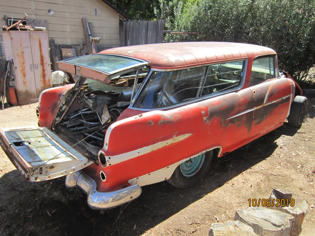

I seeking info on 56 safari. Parts I know are missing include
Inner front fender wells
Front radiator support and front sheet metal . It has nice front fenders, hood grill, two front bumpers etc
Someone previously took the whole front clip off for what ever reason and missing part must have been left somewhere
Are 56 chevy parts of above the same? ( ive found those aftermarket refab. Or are 56 pontiac parts of above available new or used original
Im still sorting through what was stored inside the car to see what else is missing.... Might be missing heater blower and firewall parts
I already researched the Vin #

Main thing I need info on right now is the inner front fender wells and front radiator area inner sheet metal
I'm kinda thinking 56 chevy stuff might be different....?

I doubt the fender wells or radiator sheet metal is the same as a Chevy, but it should be the same as any other 1956 Pontiac. Try Steve Barcak at Pontiac Heaven in Arizona for parts. http://www.pontiacheaven.org

The inner fender wells and radiator support sheet metal are the same for all 1955-56 Pontiacs. Nothing else will do.
Those parts are NOT same for Chevy. Pontiac and Chevy share upper body parts only (firewall back and above floor pan), such as glass, doors, lift/tail gate. Nomad and Safari share some body parts and some trim. Virtually nothing else is shared between Chevy and Pontiac. Body parts ONLY. Front end is not part of body.
Pontiac and Chevy station wagon bodies were made in the same Fisher Body plant and then shipped to respective Chevy and Pontiac assembly plants -- where each did their own thing with the rest of the car and they are much different. For non-body parts, Pontiac shares more with Olds than Chevy.

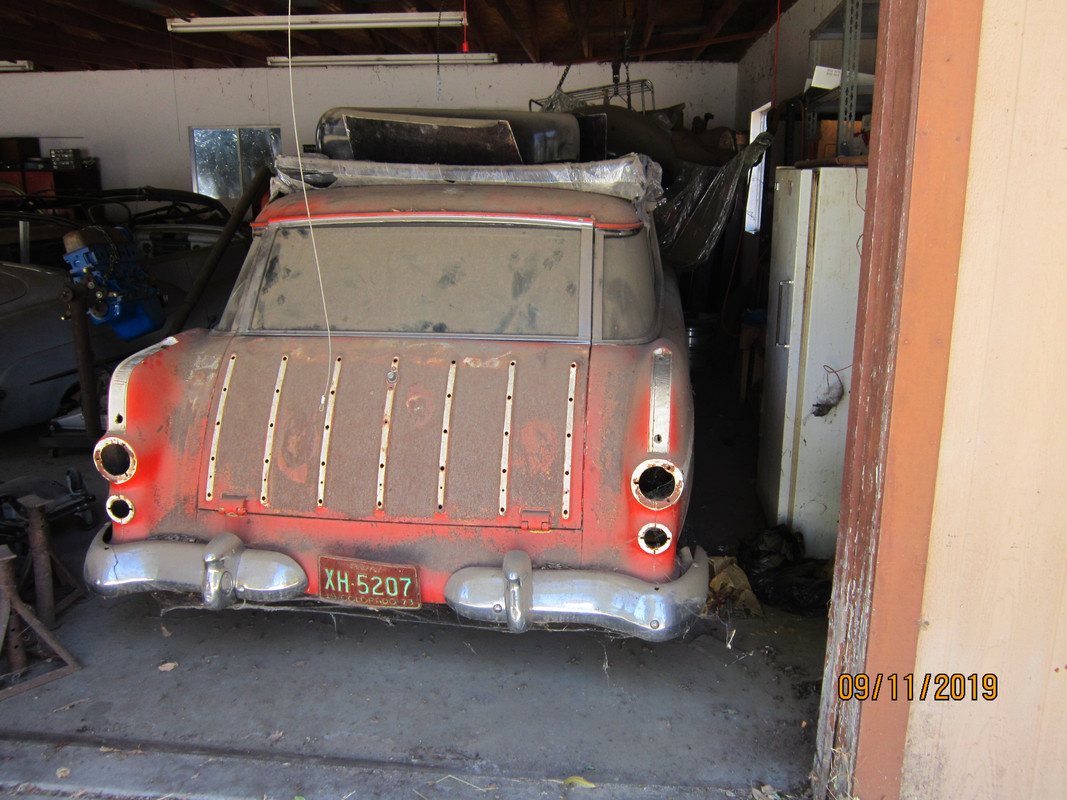

I'm the one that contacted you on the inner fenders on the HAMB. I also have the heater blower and my buddy has the tailgate stainless if you are missing that. If the tail lights are missing those can be kind of hard to find. That most certainly should be saved.

Thanks pknopp
I still havent sorted through boxes of everything, I saw the taillights in there somewhere. There are alot of extra trim and interior parts too from other 55,56 pontiacs also
