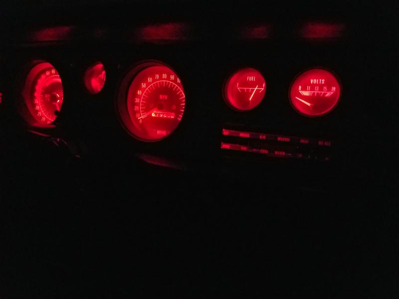

Posts: 2,590

Originally Posted by FrankieT/A View Post
I've had no problems with these as far as continually working. I just make sure the bulbs(?) themselves have the most LED's on them in order to give the most intensity. Mine are not dim-able but when going to a color they need to be as bright as possible anyway. I also changed the background color of the inside of the gauge housing to white instead of that light blue color that was original to get them as bright as possible. Probably not necessary if staying with white in which case dim-able might be more important. The picture looks brighter than they actually are, it was taken in the dark.
I've had no problems with these as far as continually working. I also changed the background color of the inside of the gauge housing to white instead of that light blue color that was original to get them as bright as possible.
I haven't had a problem with the LED's continuing to work either. I think the quality has continued to improve over the years.
On my 79 TA, I also changed the color inside of my cluster housing from the original blue to white, since I wanted to be sure the light was as bright as possible. I used gloss white for better reflectivity.
I also re-colored the back side of the black face of the cluster. You can influence the color of the light that way. I believe it was originally a light green color, which I didn't like. I painted it with a shade of blue that I preferred, which gives a slightly bluish tint to the bright white light, and it looks great to me.
Here's a night photo. You can only get an idea of the extra brightness from this. The camera was not able to reproduce the true bluish color of the lighting. It couldn't even reproduce the yellow and red on the tachometer for some unknown reason. It looks much clearer and cleaner in person, with more color, without the foggy or halo look you see in the photo.
