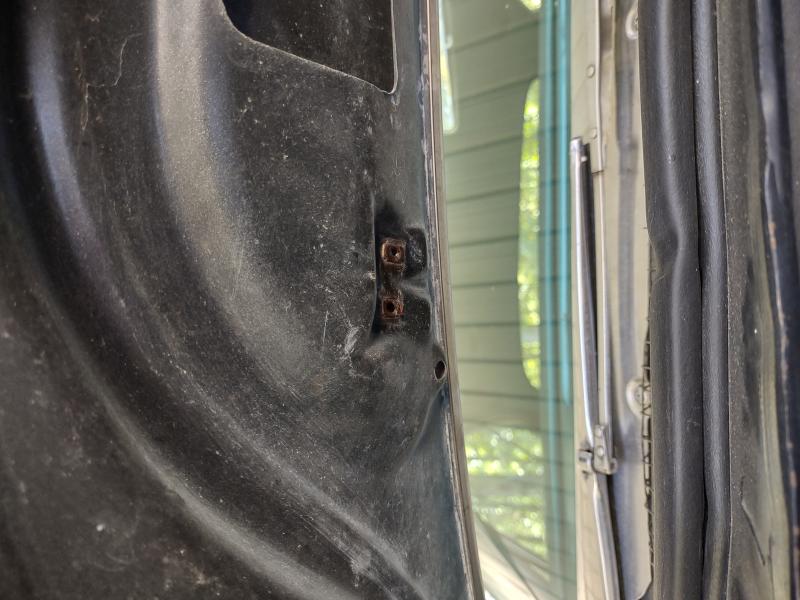

Here is a photo of the nozzle attachment area, and one of the date code for the hood ... which I have no idea how to decode. And yes the hole for the screw is quite small, and the square for the insert is about half the size of the typical examples you see for like inner fender applications. After looking at the Ames product I realized it does cover 68-72 and has four plastic inserts and four screws which would cover any combination of screws and inserts .. doesn't show any clip on nuts. I couldn't tell from the 69 assembly manual if it was showing an insert or a clip on nut. Hood uses only two screws per hood scoop ... I think that might narrow down the year.

I believe you have a '70 hood. That year washer squirter used a tab that went into the square hole and a single screw into the round hole. It was a savings of two screws per hood and the time to put in the second screw. Check your brace just in back of the hood latch catch., for '69 and '70 there was a pressed in clearance area to clear the new for '69 and up plastic shroud. A '68 hood's brace went straight back without the clearance area. Hope this helps, Paul.

Here is a photo of the underside of the hood (69-70?), and the Nozzles I have. The two matching nice ones have witness marks that appear to show that only one screw was used .. and it doesn't match where the screw holes are on the hood.
(update) Bit more research and it appears my two nice nozzles are 68 type, and yes hood is 70.
I'm guessing I can make them work regardless, even if I just use one screw, or some combination of the screws and inserts.
