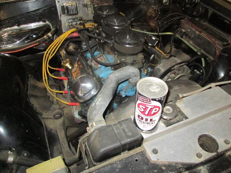

Here is a pic..It looks aweful

Old 07-02-2023, 01:50 PM

Originally Posted by grivera View Post
I have the same issue in my 64 with a Champion aluminum radiator.
Any pics of the mudflat or metal mod?
Not sure if you can see it very well. Just a heavy bit of rubber filling the gap. Foam insulation for outside pipes works, too.
