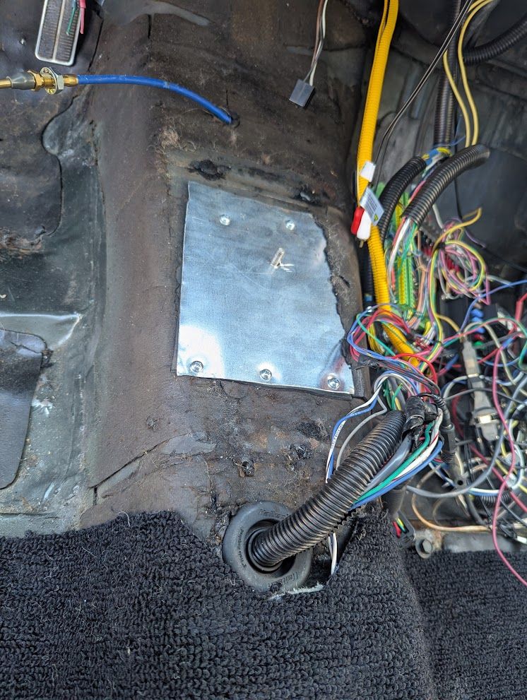

Its been a while since I've updated this thread. I've poked at the car a bit over the last few months but had been side tracked with work on my Skylark. I organized and loomed up most the wiring under the hood. Still need to connect all the wire ends to pigtails.
Put in the separate "high" power connector (blue) that brings 12v into the cabin and power out to the coils and injectors. Also added bulkhead connectors for EFI manifold vacuum and the boost controller.* So not just running a line through the firewall.*
I've just been really unhappy with the hard transmission cooler lines I had made and have yanked them all out and punted by ordering some braided flex line. I had mounted the transmission cooler to the front side of the radiator, but decided to move it to the backside of the inter-cooler so if I have to pull the radiator for any reason I could leave the ATF lines connected. I have strips of rubber tubing insulating the two coolers from one another.

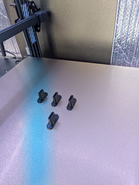

Weather has been pretty poor lately, but got a few things done today. Namely wired up the air intake and coolant temperature sensors, crank and cam sensors and main line and lash adjuster oil pressure sensors. I had previously used weather pack connectors on the crank sensor and throttle position sensor, and the connectors have always been problematic for me, so I'm replacing them with pre-made pigtails.
My car will have three or four of these hall sensors on it, so I'm making them all with the same male plug so I can swap them in a pinch, though the crank one has been on the car since 2014 and perfectly reliable. I have one on the crank, the cam sensor, and will put one on a front wheel like my Skylark for traction control. There is another I plan on running to see if I can detect crank flex from the 3 torque converter bolts. Its a long shot but doesn't really cost me anything to try.
I also bought a box of plastic clamps for holding wires and hoses.
I clipped one onto the fan shroud here and should hold the crank sensor wires away from the alternator quite well.

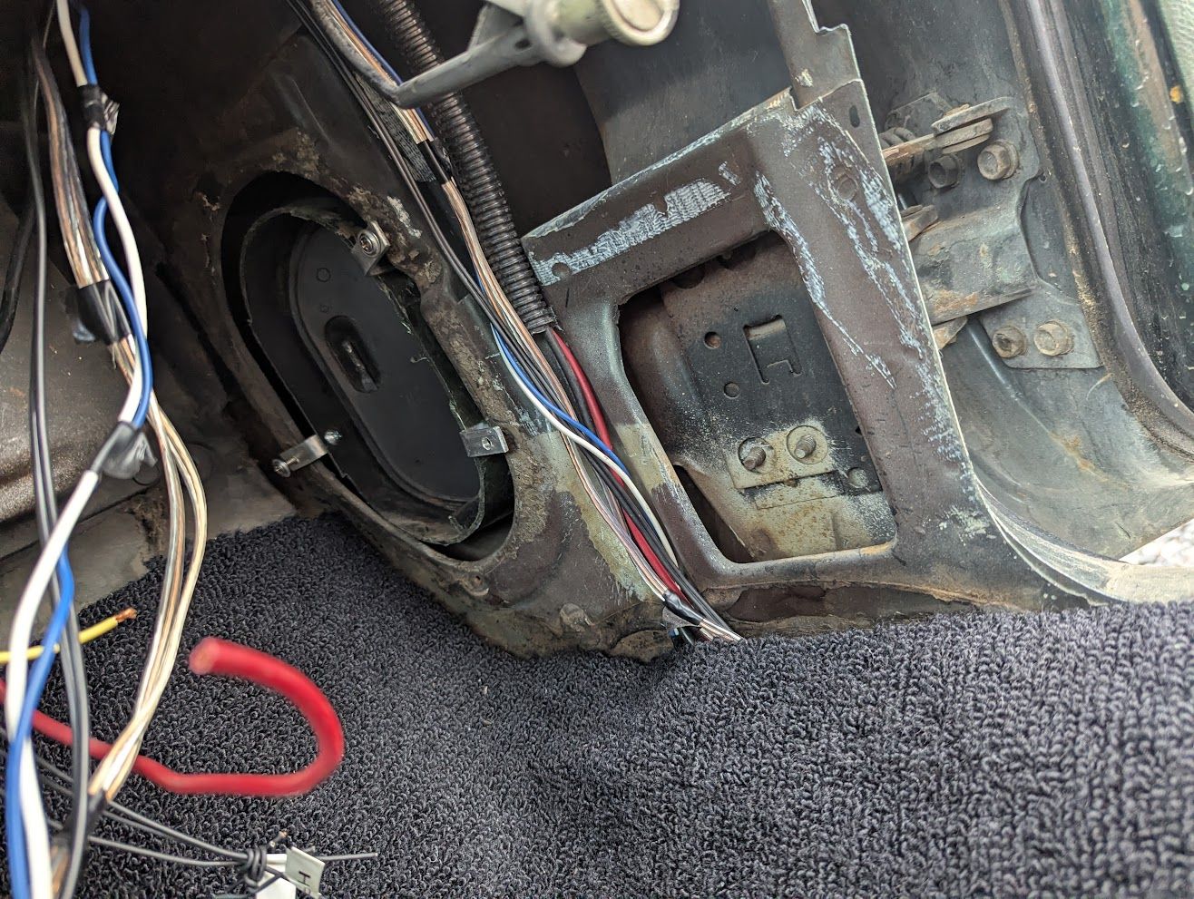

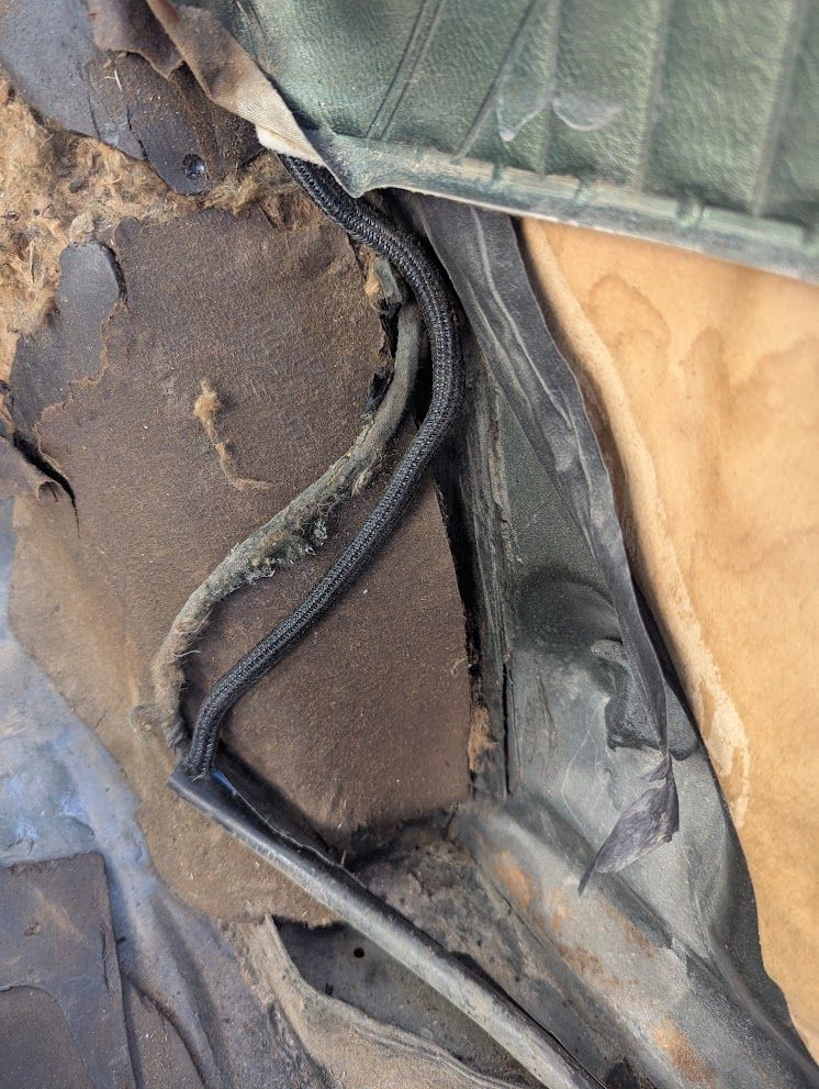

After going on vacation and having in general poor weather, I've been poking away at wiring.* Connecting up sensors, wrapping the wiring up, and just trying to make it as nice as I can do.
The most obvious change here from previously are the pigtails are wrapped in black now and I've mounted to power solenoid and two large fuses on the driver's fender.
Previously I had the power solenoid on the passenger side with a 10 gauge wire coming from the alternator with a 75 amp MAXI fuse, which went over to a local fuse panel then out to accessories. The 10 gauge wire showed some signs of being cooked* Now I have 6 gauge wire from the starter post (connected to the battery) to the alternator and then up to the power solenoid and out to two large fuses.* I wanted 75 and 100 amp fuses, so need to swap the rear fuse. The frontmost fuse is for the radiator fan, electric water pump, and any always powered accessory in the stock fuse panel. When I convert the headlights to local relays, they'll get their power from this fuse as well.* High load stuff. The rearmost fuse is the EFI and chassis power fuse blocks.* Its a 140 amp alternator, and of course battery power.*

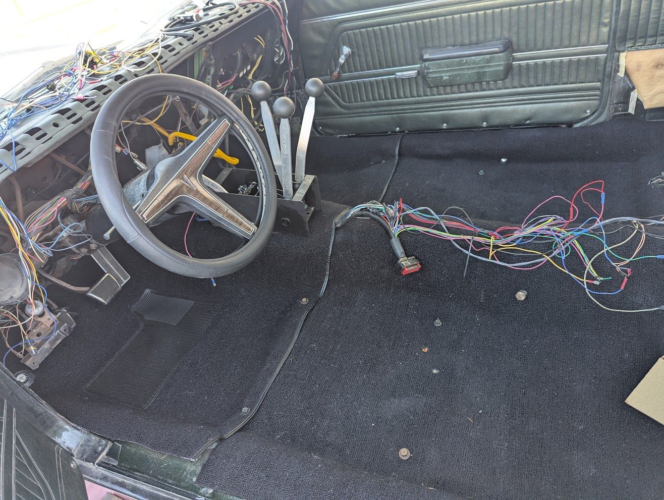

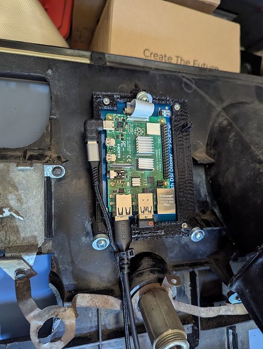

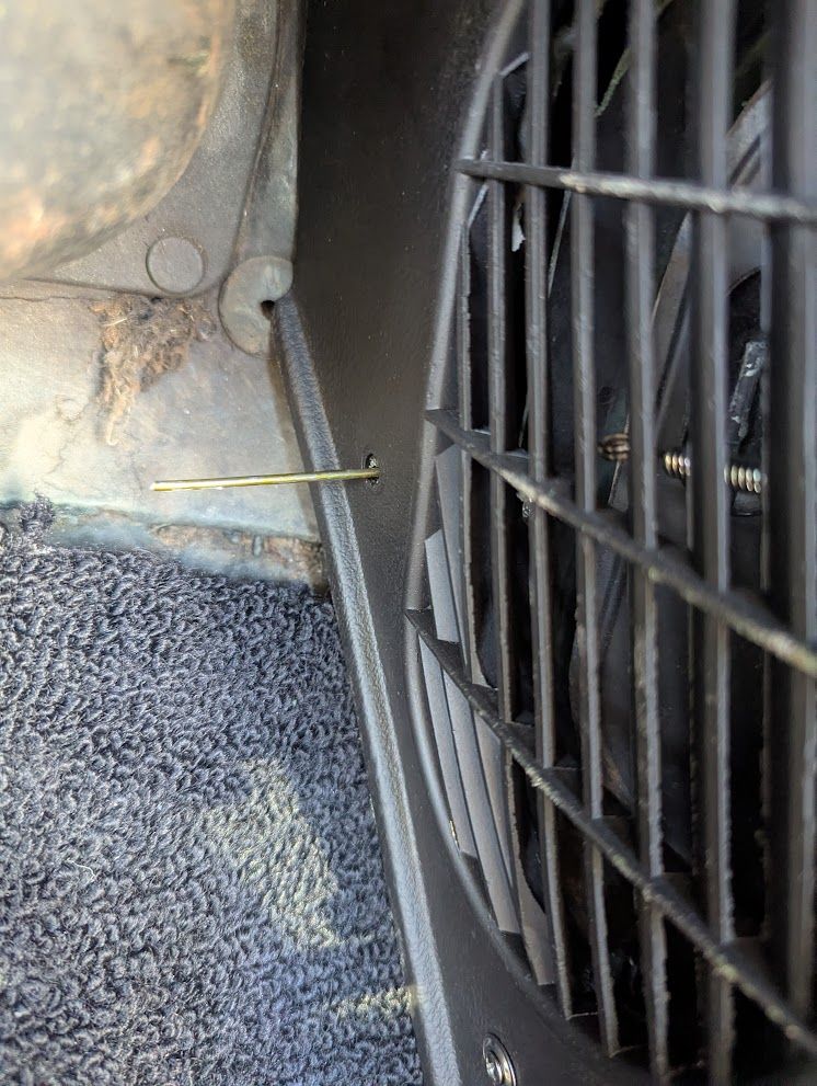

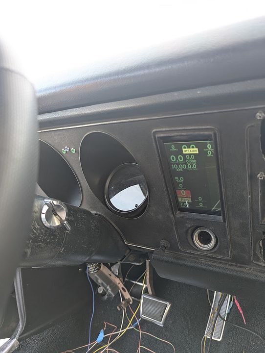

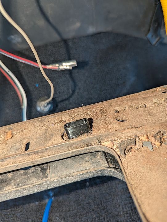

Since the weather has been poor I've been working on the dash. I've removed the mechanical speedometer from the cluster and ran the digital speedo wires through the backside now. Since the blinker and high beam indicator lights are removed I've added three lights between the pods to replace them.* I've also finalized mounting a touch screen in the dash.*
Much cleaner than wires out the front!
These wires run to a connector, and the other side of the connector I'll tie into the dash harness wires.*
For the touchscreen, I've moved from a 7" screen to a 5" that fits the area much better. Its a tad short on height, but with a minor amount of trimming it fit between the existing mounting points. For mock up it just has the screw heads holding the screen in place, but I plan on making some ABS plastic clamps to really hold it down and take up the ~1/8" gap on height. Its a fresh software install so I need to create some new custom digital gauge/indicator layouts.**
Here is a video of the screen in action.

Ran new wires to the trunk area through the sill panel conduits. Including the speaker wires, always on 12v battery power wires from the trunk battery, fuel pumps relay trigger wires and two spares for other uses.

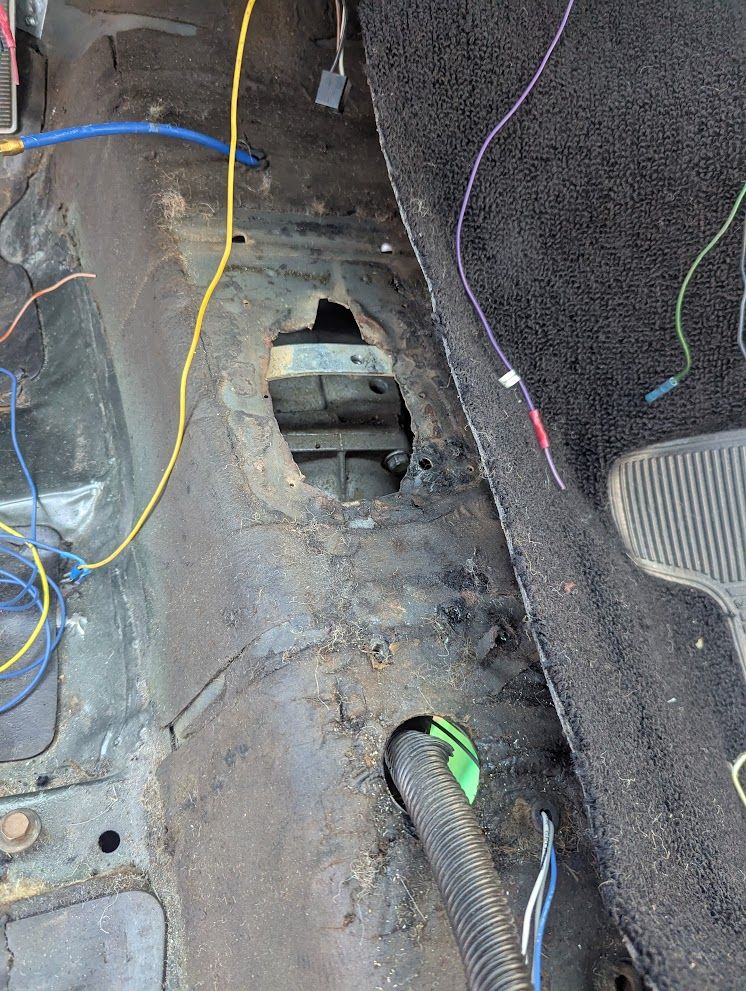

Patched the giant holes in the trans tunnel.

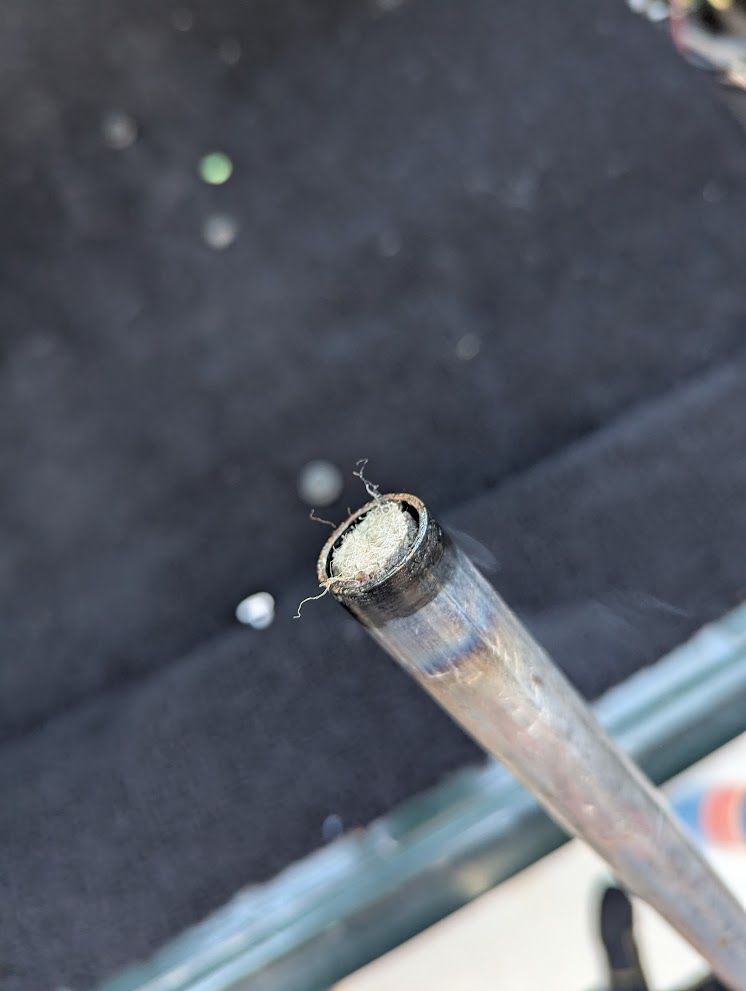

New carpet. Once in I used a heated up pipe to melt/cauterize holes for the seat belt bolts, etc.
[img]

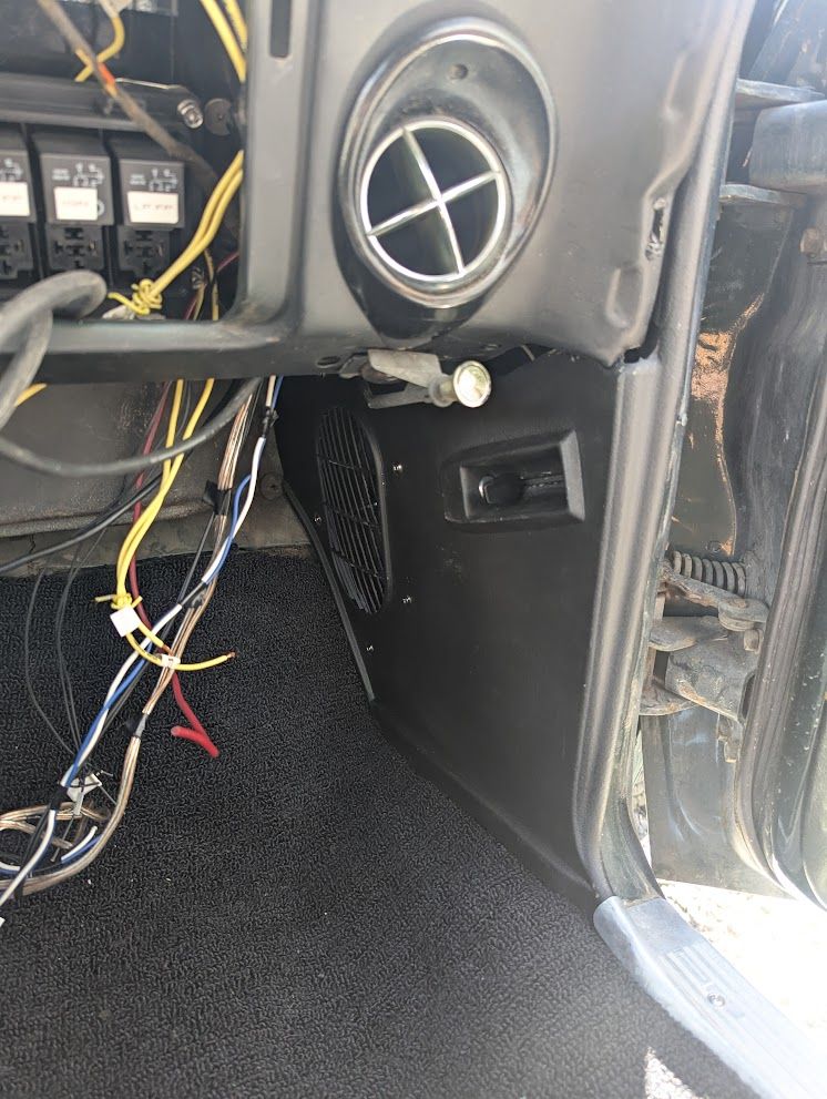

Pulled out both kick panels and painted them black. Ran all the wiring that goes to the rear through the factory wire conduits in the door sills, patched some holes in the floor pan and installed new carpet.
For the kick panels, I cut off the vent tubes, added tabs to bolt the tube in place and this should allow the kick panels to be removed more easily in the future. Particularly if I put a cage in it.

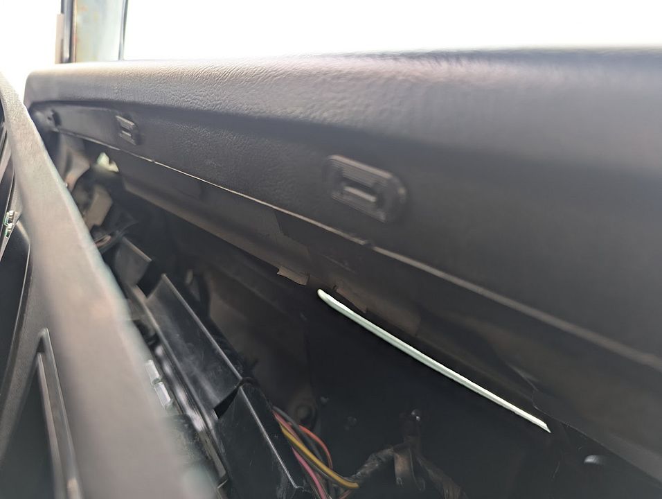

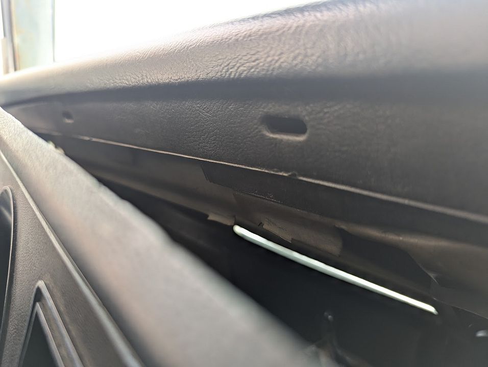

Put the dash back in. Turns out the reproduction dash pad uses metric hardware and didn't come with the clips that the dash panel screws into. I also 3D printed a screen holder for the touch screen that goes were a factory clock would go. Not the most ideal angle, but when its running and driving I'll make adjustments to the fonts and gauges to make it easier to read at a glance.
Installed a pair of front speakers. Not perfect stereo, but better than nothing that was there before.
A raspberry pi with touch screen bolted to the dash.
The dash didn't come with the plastic clips, so I drew some up in Fusion360 and printed some out.
The touchscreen layout is editable remotely via wifi. So I'll be able to adjust the fonts, colors, change read outs to gauges, etc.

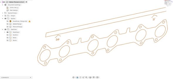

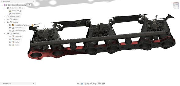

Now, I really need to get it up and driving around before I start making other changes, but I got a 3D scanner and a 3D printer in the last 4 months and have been playing around with making a new intake manifold that would bolt to the Weber intake.

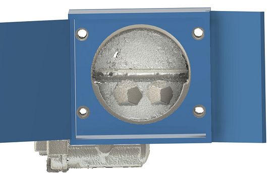

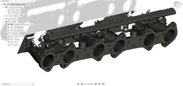

3D scanned the Weber intake, sliced the flange, digitized it and drew a new flange in Fusion360.

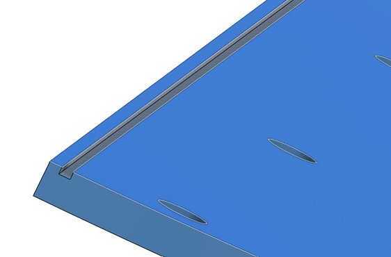

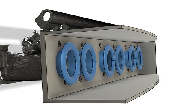

Made some velocity stacks for the ports, then boxed them in.

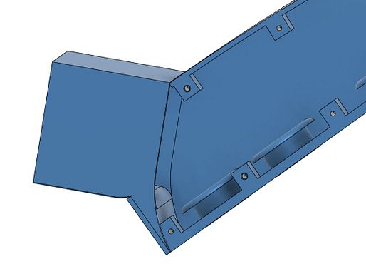

I designed it so the bottom would bolt on with an o-ring seal, and the first cylinder would get more air than the current manifold. This is first iteration, there is some cleaning up that would have to be done for a final manifold. I made a go at printing it in cheap PLA, but had an issue with the print. I need to do some printer calibration for the filament I tried to use. I fill try a more suitable ABS or such type plastic when I decide to run one. Or still proceed with a metal manifold to weld together that I can make patterns off of in CAD.

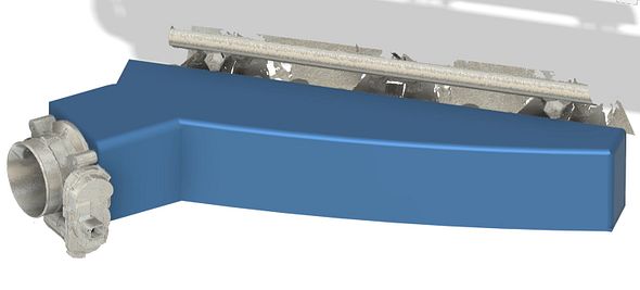

I scanned a DBW throttlebody I have to use. Added it to the model. The youtube link at the end is me testing out the DBW on the bench.

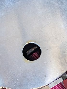

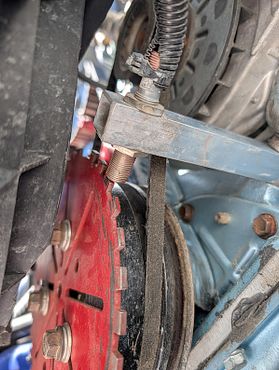

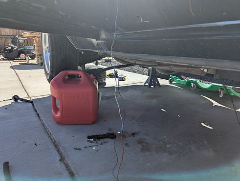

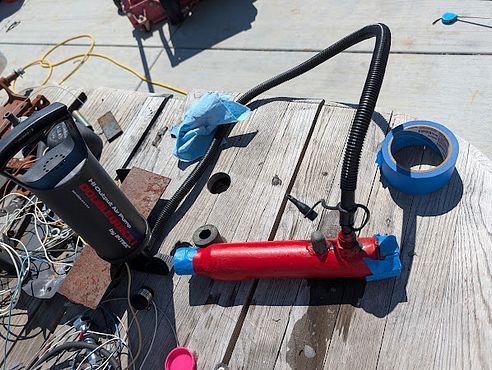

When periodically priming the oil system (and rotating the engine around) I had a leak on the turbo oil drain fitting. I tried to RTV the "hole" in place, but it didn't work so I removed it to verify the leaky section and seal it up on the table.
I brought the engine around to the #1 compression stroke and lined the trigger wheel up 3 teeth before the missing tooth (~30º) to set the cam sensor in place. The cam sensor needs to be picked up a reasonable distance before the missing tooth to tell the ECU its on the #1 compression stroke.
I have this small window a plug fits in to view the alignment between the cam sensor and trigger tooth.
