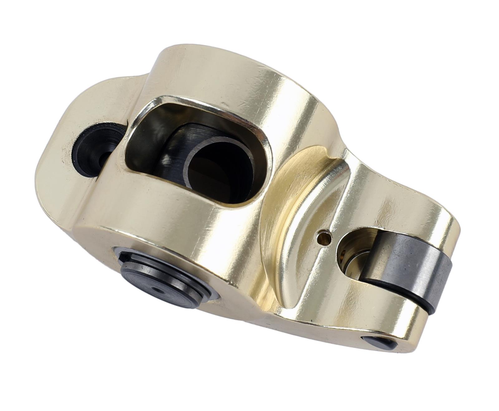

The new CompCams Ultra-Gold ARC rockers come with the spring reliefs already cut in. I do not think they sell the previous versions for Pontiac anymore.

i think i have the later versions...on the comp golds....i just need them.to hold up and clear for a hr cam

They clear my hydraulic roller just fine. Butler-CompCams 236/242, 0.573"/0.594" (1.65 ratio rockers).
